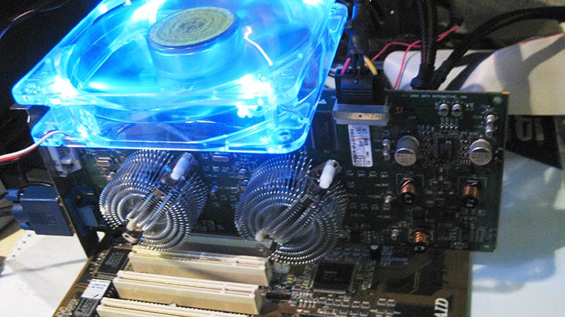

may be i missed something, but what is reason to recap v5? i have many vsa100 cards and never had any issues with caps. think much better mod for v5 is to replace chip to 320 and memory to 4ns. cutting fan connector is bad idea. you can easily remove plastic case up from pins and then desolder pins if it necessary.
here is my variant how to cool quietly

wrote:may be i missed something, but what is reason to recap v5? i have many vsa100 cards and never had any issues with caps. think much better mod for v5 is to replace chip to 320 and memory to 4ns. cutting fan connector is bad idea. you can easily remove plastic case up from pins and then desolder pins if it necessary.
No specific reason, I had the caps laying around and just wanted to make sure it'll last forever. Replacing the GPUs sounds like a nice idea but I'd have to upgrade my soldering gear first.
Some cool heatsinks you got there! Where did you find those?
Reply 66 of 73, by anthony
http://www.ebay.com/itm/Aluminium-Adjustable- … =item1c3139cd5a
Copper one exists too
