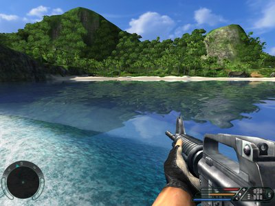

Anyways, here is a screenshot of Far Cry showing environment reflecting in water.
The attachment FarCry0000.jpg is no longer available
