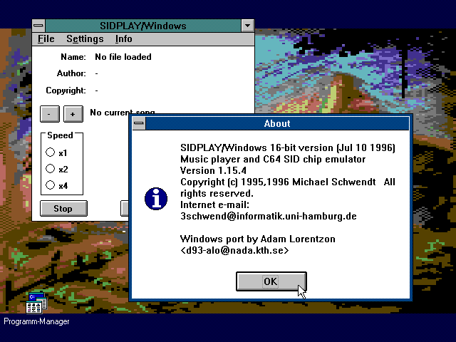

Okay, this is probably olds new, but..
SIDPLAY, the MOS SID emulator intended for C64 music, also had a Win16 version.
- A video of it running on OTVDM can be seen here: https://www.youtube.com/watch?v=axlwvRDv0U4
Screenshot attached..
    11.14 KiB
    2148 views
    SIDPLAY v1.15.4 (Win16)

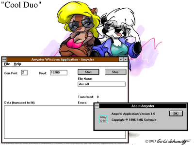

Quick update..
I found something also interesting that's no emulator, but useful for emulation.
- It's "Amyxfer", a transfer program for ADF files that runs on 16-Bit Windows and uses the COM ports.
Screenshots attached.
PS: I've choosen this background picture for obvious reasons.. 😉

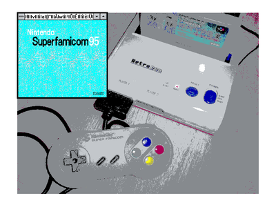

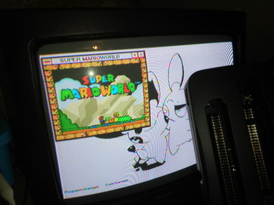

Update.
Found a Super NES emulator for Win95&Win32s.
Needs more testing..
Edit: Some more testing. Used my own carts..
    157.95 KiB
    1828 views
    Test 1
    124.22 KiB
    1828 views
    Test 2

jmarsh wrote on 2020-08-20, 01:53:
Looks like it's trying to use hi/true color and being downconverted?
Well, yes. It has to do with colour depths. The program uses WinG and draws an error message about colour depth (wants 16c or 256c).
Since the Super NES has a very high colour dept (over 4096c or so if layers are combined), the emulator likely uses all 256c available.
Because of this, I assume, the "static colours" (20) that are reserved for Windows GDI (?) are used up, as well.
If the program uses 235 / 236 colours or less, the desktop should be left in intact. So far goes the theory. What really happens.. I don't know. 😅

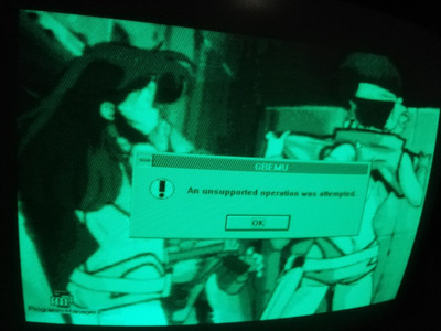

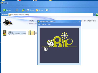

Quick update.
Found a copy of a beta version of Hyper Boy, a Gameboy emulator.
The game's binary seems to excecute on Windows 3.1+Win32s, but something vital seems missing.
On Windows XP, it "works", but causes a high CPU usage (78%). Maybe needs compatibility mode.
Tested on real hardware.
Screenshots and photo attached.

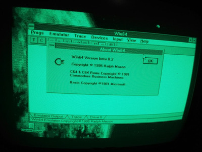

Update.
Found another emulator, Win64. It emulates a C64..
Program seems to run perfectly fine on Windows 3.1+Win32s, but there's no video output..
This makes me wonder if some popular GDI features are generally missing in Win32s or the Win3.1 GDI.
    122.51 KiB
    2091 views
    Win64 Beta v0.2 (Win32s)

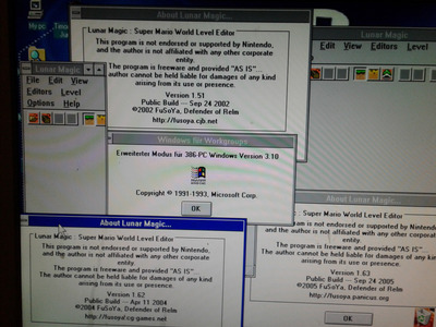

Quick update.
Discovered something interesting that runs on Windows 3.1: Lunar Magic 1.x, a level editor for SMW on Super NES..
Source: https://www.smwcentral.net/?p=viewthread&t=95320&page=1
Edit: The complete set of Lunar Magic can be found at:
https://www.smwcentral.net/?p=section&a=details&id=22116
    489.47 KiB
    2081 views
    Lunar Magic v1.51

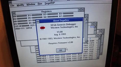

Quick Update.
Not really an emulator, but the software for the Sega Dev Card runs on Windows 3.1x. Partly, at least.
An overview video (not by me) can be seen here: link.

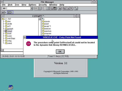

I've also checked some programs on Windows NT 3.1 in the mean time.
The result was rather dissappointing. Win NT 3.1 is very limited by todays standard.
In fact, it can't even run the most basic Win32 applications that instantly execute on Windows 3.1+Win32s.
Not even "Lie about Win32" (win32lie) does run on Windows NT 3.1.
It's related to the Windows API and the PE header. Programs expect to find at least Version 3.50 or 4.0.
The 16-Bit counter part (lieversn) runs, but isn't of much help.
Only very old Windows 3.x programs use the 3.95 version number to detect Win95.
To make matters worse, the execution is very, very slow. At least in Virtual PC 2007 on a Pentium III based laptop.
At least for 16-Bit programs. A Windows 2.x image viewer, easel, from the 1980s takes minutes to load a GIF image,
while Windows 2.03 and Windows 3.1 need about 10-20 seconds on a 286-10.

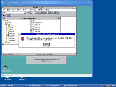

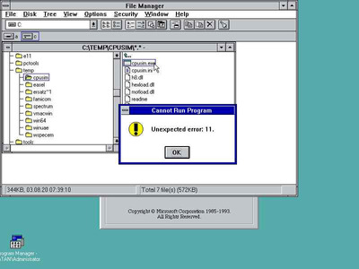

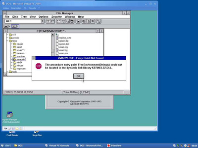

Quick update.
I've tested vMac and some other emulators on Windows NT 3.1.
The result wasn't very good. Many programs wouldn't load.
Windows NT 3.1 apparently is too old to load newer PE files ("unexpected error 11").
The only workaround is to manually patch each of the EXE files' header.
