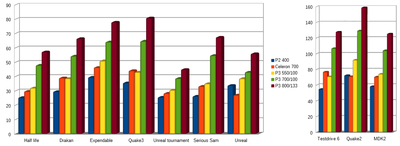

Your thread made me really wonder how bad these celeron CPUs are. I ended up doing a comparison of a celeron 700 and a few other CPUs. I used an aopen AX6BC 440bx board (mainly because it works with slot1 and s370 cpus) with 256MB of PC133 and a radeon 8500 (was going to use a 9700pro but it didn't like the higher AGP clock that you get on a BX board with a 133MHz FSB). Sound was enabled for all the tests and I used an SBlive card. The results were all at 1024x768 resolution, half life was 16bit colour and the rest were 32bit.
Here are the results:

It does look like your results are better than mine for the 700 so I must admit there could be another factor in my setup that's affecting the results. However I think it's still safe to say that the FSB speed of the chip is huge and the C700 is a poor performer because of that. I could have upgraded to a faster chip but I deliberately chose the 733 because it was as close as I could match the speed as possible while just getting the faster FSB and extra cache. I think 33 MHz is within the margin of measurement error and should not be attributed to the dramatic increase in speed I saw. Thanks for posting these results. They are quite informative.

Wow, I'm surprised that the Celeron 700 performs THAT bad compared to the Pentium II. On the other hand, I've had my share of Celerons over the years, but never ran one at less than 100 MHz fsb .. That might influence my general view on Celerons .. 🤣

FSB + Cache FTW
yep, and even that 700 should be able to reach 90-95MHz FSB with some overvolting (100MHz if you are lucky)
