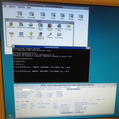

red-ray wrote:
Thank you, maybe NT 3.51 is different, please try SIV32L.exe -DBGINI -NOSIVRES > SIV_DBGOUT.log | more. Ideally use Beta-12 as I […]
feipoa wrote:
SIV_DBGOUT.log was not generated in the SIV folder. I'm using the original version you posted, not the beta for NT.
Thank you, maybe NT 3.51 is different, please try SIV32L.exe -DBGINI -NOSIVRES > SIV_DBGOUT.log | more. Ideally use Beta-12 as I added some extra debug traces.
Beta-11 was not ideal so I made some more changes for the attached Beta-12, please try it on W95C (It should say 95C). Again use SIV32L.exe -DBGINI > SIV_DBGOUT.log | more so I can see how the detection is done.
I tried to install NT 3.51 on one of my systems, but thus far the install fails. I suspect I need to use an older system. Do you have any other systems with NT 3.51 installed and if so how does SIV do?
EDIT: I think I have found the issue with NT 3.51. It seems to have issues loading images from SIVRES.dll so please try SIV32L.exe -DBGINI -NOSIVRES > SIV_DBGOUT.log | more on 3.51
Beta 12 still generates a Dr. Watson in NT 3.51, but I was able to run, SIV32L.exe -DBGINI -NOSIVRES > SIV_DBGOUT.log | more
See attached log file and screenshot.
The attachment NexGen-NT35.jpg is no longer available
The attachment SIV_DBOUT.log is no longer available

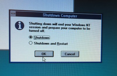

After running this command I was unable to shutdown the system. I try to shutdown normally via the GUI (see image below), but after hitting OK, the system continues running as if I never asked it to shutdown.
The attachment Shutdown.jpg is no longer available
Concerning Windows 95c, I no longer needed to run IDON.COM to use SIV32L, so whatever you adjusted worked.

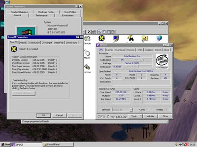

Reply 68 of 465, by Sedrosken
This is how it looks on Al-Jalima running NT 4.0 SP6a. I can actually run the Win98 version just fine, but this version manages to catch some aspects of my system that version can't, like my actual motherboard model and its chipset. Please consider letting us bench against some more powerful chips like the PII-450 and such, the most powerful chip I saw in the drop-down menu was a PMMX166 that I wiped the floor with, especially in FPU.
The attachment JST-ALJALIMA.txt is no longer available

Using 5.41 Beta-15 on NT 3.51 please will you do SIV32L -DBGINI > SIV_DBGOUT.log | more, generate the two save files (Menu->File->Save Local) and either post or email them to me along with SIV_DBGOUT.log? The .DMI file is a dump of the BIOS data that's used to generate the [Machine] panel. Once I get these I suspect I will be able to improve the motherboard reporting.
If you do Menu->Machine->Shutdown what happens? Was SIV32L still active when you tried to do the shutdown? Can you post the Task Manager screenshot so I can see which programs are active. Post Menu->Edit->View STC Info so I can see what the SIV worker threads are doing.

Reply 70 of 465, by red-ray
I suspect most of this is down to CPUZ 1.89.3 being newer than the Windows 98 version you have.

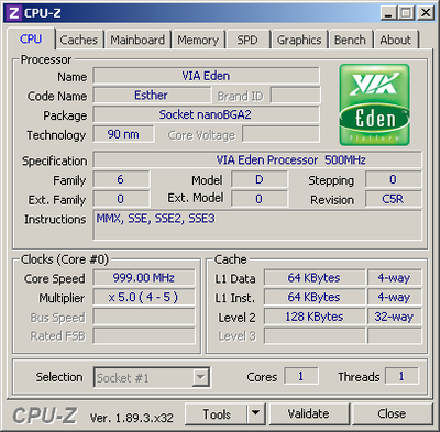

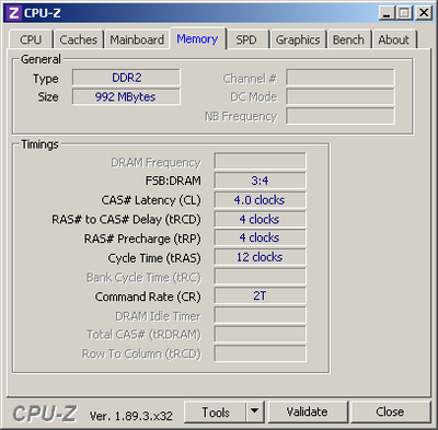

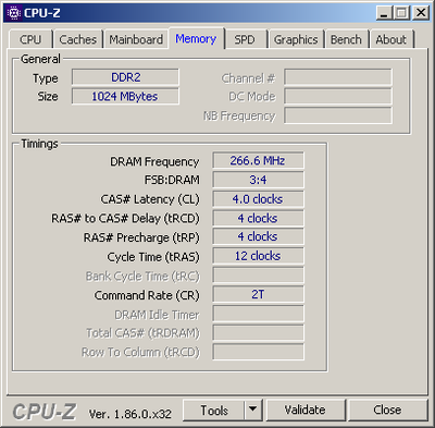

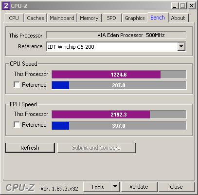

I ran it on my ComputerLab ST5500x thin client (VIA Eden-based.) A couple minor issues:
The attachment cpu-z main window.png is no longer available
- the CPU is reported as a "VIA Eden 500MHz" running at 1GHz (5 x 200). I think this is a problem with the CPUID as it happens in everything, including SIV, Windows's device manager, and Linux's /proc/cpuinfo.

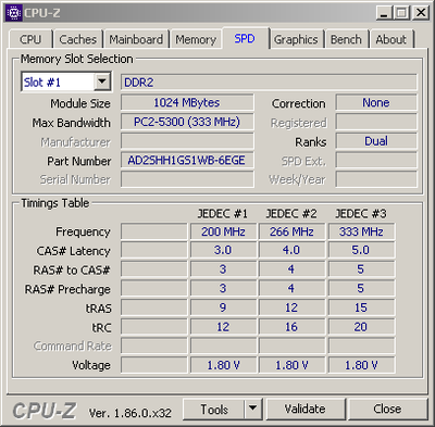

- this build of CPU-Z can't detect the RAM frequency and shows no info (blank page) under SPD. CPU-Z 1.86 x32 doesn't have this problem:
The attachment cpu-z_1.89_no_ram_speed.png is no longer available
The attachment cpu-z_1.86_ram_speed.png is no longer available
The attachment cpu-z_1.86_spd.png is no longer available
- this build takes much longer to start up than 1.86 and seems to spend a long time around 20-25% when it tries to read the SPD. Probably related to above.
Here's the benchmark:
The attachment cpu-z_VIA_Eden_bench.png is no longer available
Note that this machine runs at 1GHz, not 500MHz.

Reply 78 of 465, by CuPid
Thanks xjas.
Yes your cpu does well run at 1GHz. The processor name string is not well programmed (most likely a BIOS issue).
I made some fixes, hoping that this solves most of the problems that you had.
http://download.cpuid.com/betas/cpuz_w95.zip

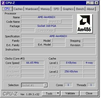

Reply 79 of 465, by PARKE
Just downloaded the last version above here. Intel 486DX2-66 (SX750) is recognized as an AMD chip. Biostar MB-8433UUD-A with Windows 95.
