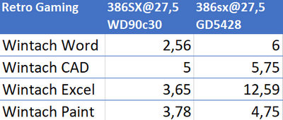

Reply 64 of 92, by Marco
FYI I recently benchmarked my Win95 performance with and without GDI acceleration:
Ha, ok sometimes more, sometimes less increase. But remember that the 386SX will be the bottleneck anyway.

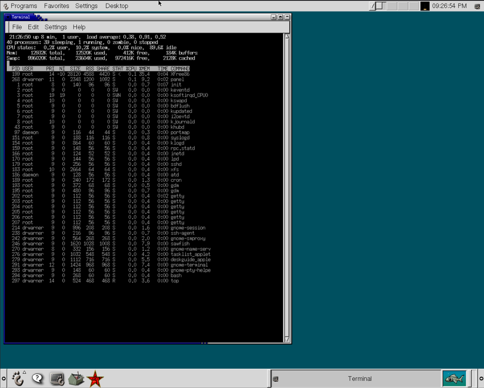

For what it's worth, I think Debian 3.0, "Woody" was the last version to offer 386 cpu support. I don't know if you'd count this, as support for it ended in 2006. I consider it retro, but it's not necessarily 'era appropriate' for a 386.
It includes Linux Kernel 2.2 and 2.4, Xfree86 4.1, KDE 2.2, and Gnome 1.4.
I spun it up in a VM on proxmox, telling it to use 486 as the CPU, 16mb ram and a 32GB IDE disk.
I booted using the 2.4 kernel, and although the proxmox bios didn't have any 8GB boot limitations, I made a 256MB primary partition for /boot just to see if anything would go squirrely on me, a 1GB swap, and the rest for the root.
It took a hot second to do, but I did get it installed and booted into a gui. The results aren't impressive - before the GUI even starts, 100% of system ram is used and it uses an additional 18MB of swap.
If you want to give it a spin, you can grab installers (and indeed the entire software release) from here: https://cdimage.debian.org/mirror/cdimage/arc … ve/3.0_r6/i386/
I have no idea how well it would run on a 386 though - my guess is that with 8MB ram it would be effectively unusable.
Reply 66 of 92, by Takedasun
Marco wrote on 2024-01-30, 08:58:
Resolution and color depth?

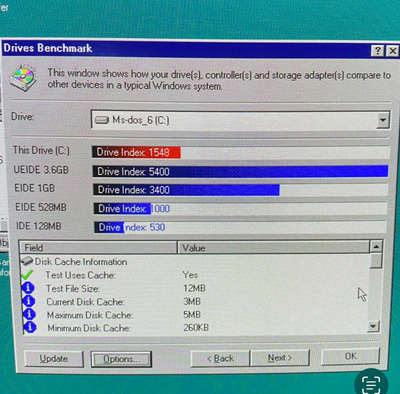

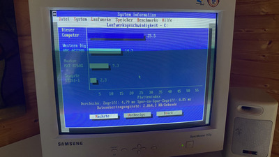

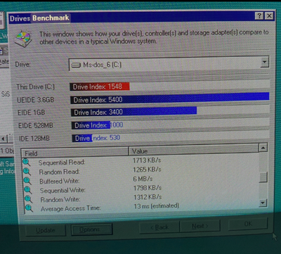

Reply 67 of 92, by Disruptor
Marco wrote on 2024-01-29, 22:01:
2. I cannot confirm the scsi remark. First the bus master feature is known to not really do on 386. I benched a lot and posted it here somewhere months ago. Result: the 160gb Seagate will do it much better and more silent than anything via scsi. Maybe also because of 8mb cache. I benched program start times I also benched opening apps while doing file transfers in the background. At least for me it was really not being worth it by far. SCSI2SD setups might be best of all maybe.
How much MB/s did you pump out of your 160 GB HDD?
Reply 68 of 92, by deltapi
deltapi wrote on 2024-02-09, 22:45:
Quick update, with the GUI loaded, it's using a good 23+ MB of swap just idling.
Reply 69 of 92, by zyga64
Maybe use lighter WM like Window Maker or JWM (or something from that era). Gnome was considered heavy even at that time (2002 - Debian 3.0 release)

Reply 70 of 92, by Marco
Takedasun wrote on 2024-02-09, 23:47:
1024x768x256

Reply 71 of 92, by Marco
Disruptor wrote on 2024-02-10, 00:26:
I think these were the results.
