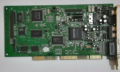

Reply 62 of 76, by Intel486dx33
Yes, this terratec maestro is almost the same as the Opti card I posted above.
And since I already have a few of these Opti card I will use one.
The actual Terratec card cost too much in America.

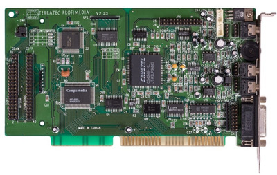

Reply 63 of 76, by Intel486dx33
I would like to have this one if I could find one.
    127.23 KiB
    1025 views
Reply 64 of 76, by Caluser2000
Both were made in Taiwan so shouldn't be that hard to find.

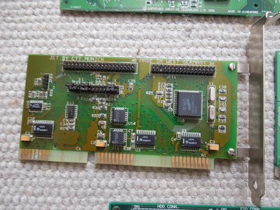

Reply 70 of 76, by imi
interestingly enough I saw a german made hdd/floppy controller on ebay recently ^^ made me think of this thread

Reply 75 of 76, by pentiumspeed
IDE and floppy controller card has the vias made using conductive paint. Not very smartest way to do. Electrolytic goo eats this very easily. Back in the day (during 2003 thru 2010), I had rare type of TV that had a PiP module that cannot be bypassed like others I can easily bypassed using two capacitors. Had to be fixed at this point.
So I checked the module board and found few corroded vias done like that way and fixed them and replaced capacitors.
