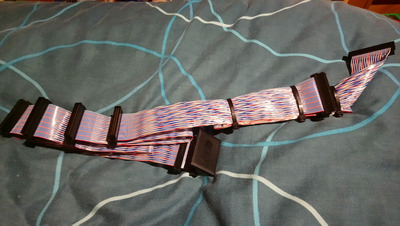

Reply 71 of 81, by teh_Foxx0rz
I know the Force SE jumper is there, so I was just going to try things without that and then add it on if that doesn't work. Seems like a pretty simple concept to me xP
And alright alright, here's the cable I have to put that to rest lmao. It is long, but it doesn't seem even close to the three meter maximum of SE SCSI.
Reply 72 of 81, by Disruptor
teh_Foxx0rz wrote on 2023-11-07, 22:10:
Are there any LEDs on the backside of the terminator?
Are there broken pins on the connectors of the cable?
Reply 73 of 81, by teh_Foxx0rz
No LEDs no. But no broken pins.

Why would it matter what the cable looks like?
The drive is native LVD because its Ultra160. The 2940UW simply isnt capable of LVD.
The drive might auto negotiate the bus and switch to SE mode or it might not. If you set the jumper it will run in SE mode.
It really is that simple.
That would be technically the correct thing to do wouldnt it?
By the looks of it she might have an LVD cable, and an LVD drive with an LVD drive caddy, but the controller isnt LVD so do you think it will run in LVD mode?
Seems like a good thing to try. It should negotiate to SE mode, the Force SE jumper is there to do just that, it forces it so it wont try LVD mode thats all.
All setting that jumper does is the drive wont even waste its time trying LVD mode, it will just use SE...
