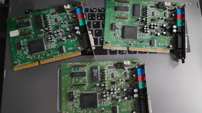

Reply 639 of 782, by Ulfenknulfen
The 3 here are already looking forward to it 😀
best regards
Paddy
