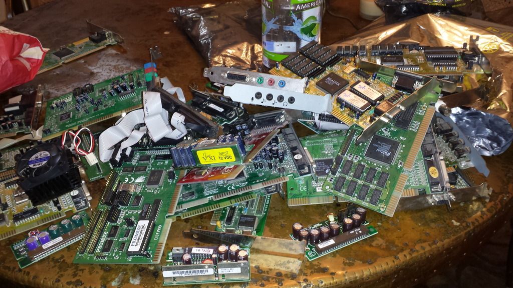

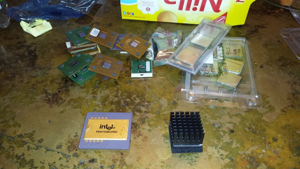

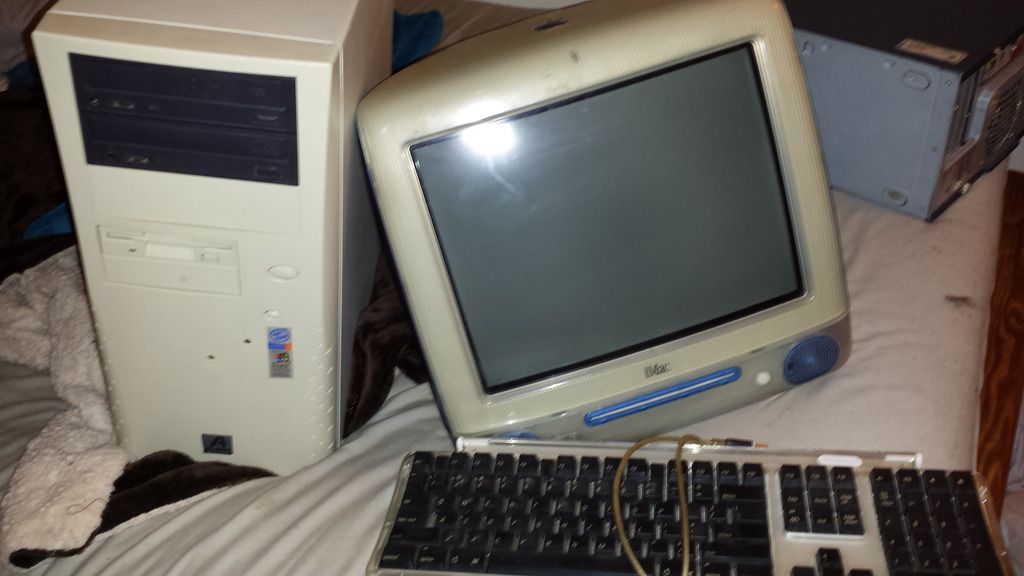

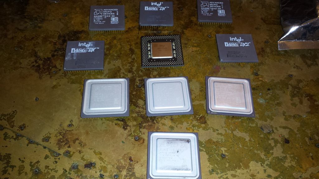

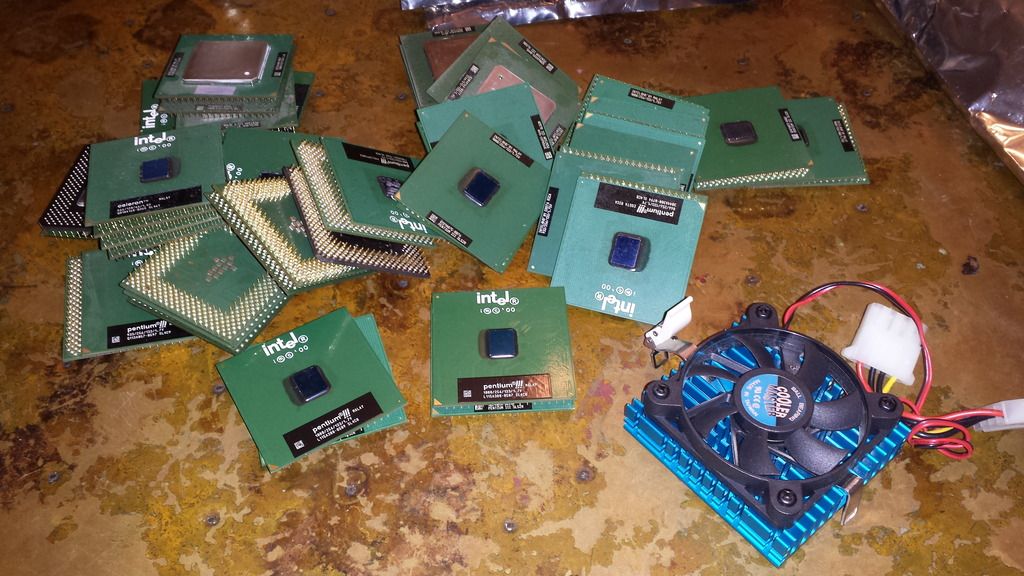

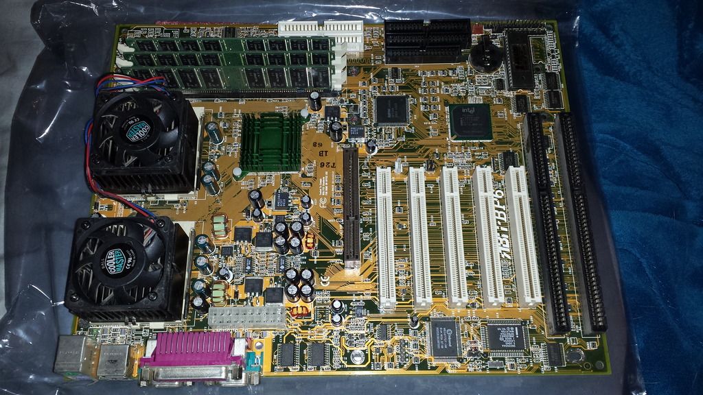

Bought a few 486 off a guy whose add I responded to on Craigslist a few years ago. kept in touch and this week he gave me a call and wanted to unload a bit of his collection and asked if I was interested. of course I was. its mostly odds & ends all was free though.
