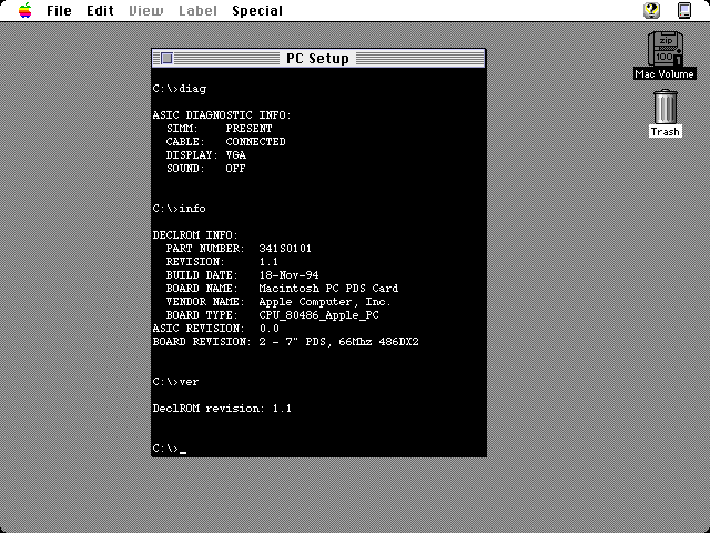

Interesting function here:

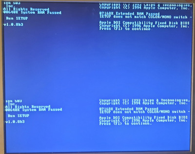

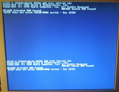

Tripping up an error message on a soft reboot:
The attachment 20230122_212015.jpg is no longer available
The attachment 20230122_212118.jpg is no longer available
What do you mean "Run Setup"? There is a Setup screen?
Looking up in a Bios dump made in Dos, which is really just a resource inside the pcsetup application, there are mentions about pressing "F2 to enter the bios setup now", or ctrl-alt-s, and the latter works just after the memory check, it's not mentioned on the screen though.

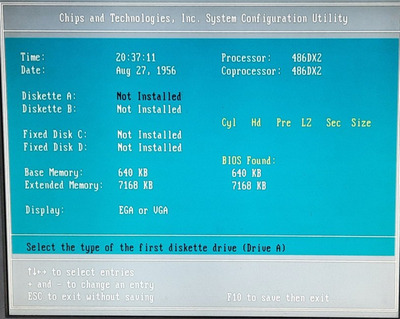

Accessing the Cmos Setup:
The attachment 20230123_131438.jpg is no longer available
Drives and Display settings can be changed but don't do anything on reboot.
