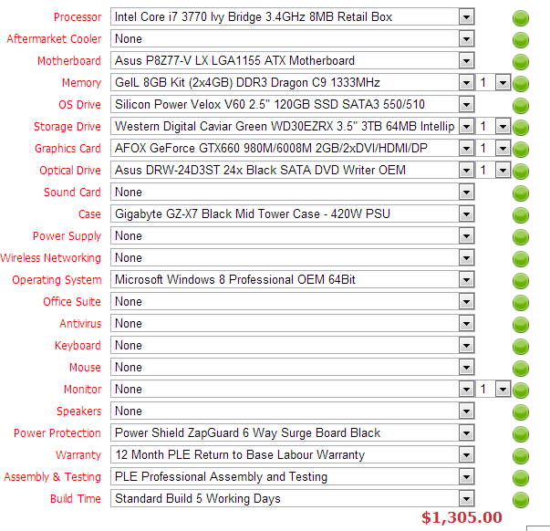

Reply 83 of 126, by Mau1wurf1977
Gemini000 wrote:
Geeze, these numbers are adding up. I've already somehow brought the total up to $1,457 before taxes, and I originally budgeted for $1,300 before taxes. The taxes themselves will probably add another $200ish to the price.
Our currencies are pretty much on parity. I put together a system with my favourite computer Shop in Perth.
If you could do a cost break-down, maybe that would help?
The system is based on the i7 3770, 8 GB, 120GB SSD + 3TB WD Green, 660GTX...
You didn't mention monitor, keyboard mouse and any of that?
Who is the "best" online PC shop in Canada? Is there a newegg equivalent?
My YouTube channel
