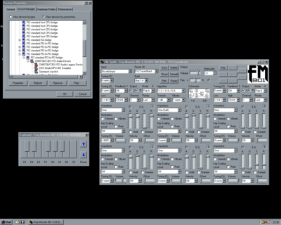

Kamerat wrote:
Got OPL passthrough working on my Philips PSC605 under Windows XP, but unlike my Zoltrix Nightingale it can't mix OPL to the SPDIF output. I think the whole PSC60x series uses rebranded CMI8738 chips and on the HP OEM PSC1602 you can actually find both rebranded and non rebranded CMI chips.
Using the same card behind a PCI to PCIe bridge under Windows 98 right now, accessing the FM synth through port C850h. I initialize the card with "SETAUDIO.COM U" before I boot Windows. Haven't tried it under NT based Windows yet.
93.96 KiB
2587 views
Edit: Tried with Adlib Tracker II under pure DOS, also working when set to port C850h (C800h is the PCI base address of the card revealed by SETAUDIO).
Edit 2: Seems like it's unnecessary to initialize the sound card at all, the FM synth is always aviable at port C850h.
Edit 3: Using DOSMid it seems like the MPU interface are located at xx40h, C840h in my case.
YouTube channel
