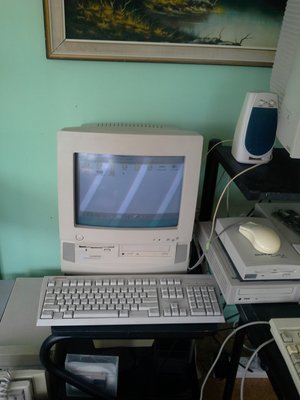

All back together. Nothing damaged and running like the tramp it is. Remember folks if you are going to play around with a computer by removing/fitting parts and connector for goodness sake do disconnect power/power off and make sure you earth yourself out in some way. By either an earthing strap or touching the metal surround/casing. It'll save you a lot of grief in the long run.

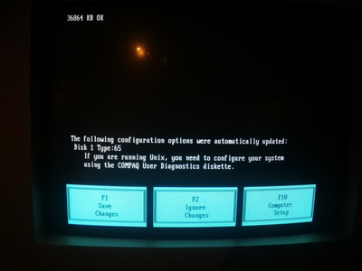

Hi

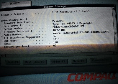

Ive recently configured this computer (CDS524) with a IDE to CF card adapter. Ive mounted a 4GB card to it and struggle to configure it. Ive managed to setup the BIOS, so I can now load into Win95 or DOS, but everytime i start the computer I get this anoying message:
"The following configuration options were automatically updated:
Disk 65 Type:65
If you are running UNIX, you need to configure your system using the Compaq User Diagnostics diskette."
F1 Save Changes -> soft reboot happens and the disk error message. I then need to pull out CF card, reboot save changes, boot with diagnostics floppy and manually setup CF card.
F2 Ignore Changes -> leads me into loading OS and everything works smoothly, 2 partitions with 2GB each.
F10 Comupter Setup -> leads me back to bios setup with a message that storage has been configured
The anoying thing here is if I accidently push F1 at startup I'll have to open the case and resetup CF card.
Wow long message 😀 Hope somone has time and knowledge.
Regard Walter
Reply 85 of 93, by NORTHERN WALLY
Just to add:

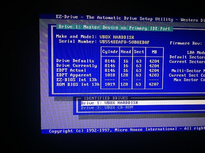

I've check with another old Pentium computer what the disk geometry is , and also verifyed this on my Compaq with programs like "WHATIDE.EXE".
They read out:
Cylinders 8146
Head 16
Sectors 63
MB 4204
But in my Compaq Bios - Inspect function says:
Cylinders 1018
Head 128
Sectors 63
MB 4203
Still I manually override this in Bios setup and the disk works perfectly (except the startup-message).

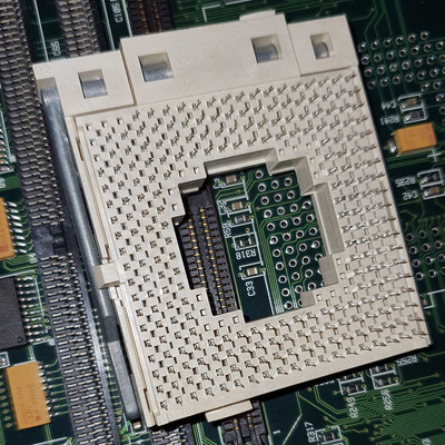

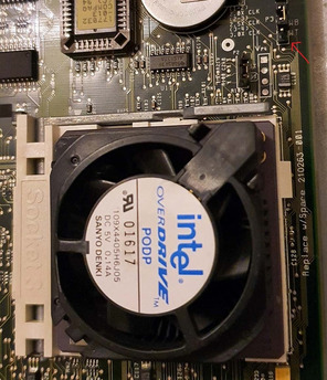

Just wanted to share an amazing mod that i saw for the compaq cds 500 series model.
As you may or may not know, you cannot use the intel pentium overdrive since it's only compatible with socket 2 and 3. The Compaq has a cpu socket 1, but what I never noticed is that it actually has the missing socket 2/3 holes in the mainboard.
221.29 KiB
1066 views
So this user "FabFr" @ vcfed.org described his mod, where he was able to remove the original socket 1 and solder a socket 3 into the mainboard and managed to get a CDS 524 working propertly with a PODP5V83 cpu.

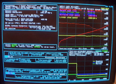

Not only that, he also managed to solder the missing pins into jumper P3 that is related with WT/WB cache selection. Would be really interesting knowing if L1 WB cache is really working. Maybe someone here can analyze the speedsys graph below.
