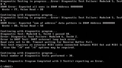

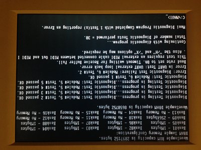

I just ran MAUIDIAG on one of my Mauis:
After loading the DIAGMAUI.MOT firmware the program performed the tests and displayed no errors. The test machine was an AT&T Globalyst Socket 4 computer with Pentium 66. PCI / VLB / ISA type, non PnP. MAUIs addresses are set to 330h / i2/9 (standard). The tested memory were two different sets, 2x 4MB modules each, one 3 chip configuration (with parity), 60ns and one 9 chip configuration (with parity), 70ns. One pair had gold plated contacts, one pair had tin plated contacts. With both pairs the reported memory size was: 8650752 bytes.
Literally "hours" later, all tests were "passed OK".
//edit:
I got an error with another pair of RAM that has been tested with memtest before:
    2.14 MiB
    1584 views
    MAUIDIAG ERROR
www.AmoRetro.de Visit my huge hardware gallery with many historic items from 16MHz 286 to 1000MHz Slot A. Includes more than 80 soundcards and a growing Wavetable Recording section with more than 300 recordings.
Reply 87 of 104, by bristlehog
This is not a memory error, but UART external loopback error, as seen in error description. I get this UART error everytime, which is normal.
Ok, seems either my Maui is faulty, or 80ns memory is too slow for it.

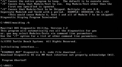

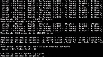

Ok. I just tested 2x 16MB 60 parity and it did not work. Here is the result:
80.85 KiB
1549 views
TB Maui 16MB x2
With a single 16MB 60 parity stick.
121.84 KiB
1549 views
TB Maui 16MB x1
It shows up as 4MB and shows a similar error.
83.55 KiB
1549 views
TB Maui 16MB x1
edit:
Don't buy 16MB sticks; they won't work.
Maybe your SIMMs are 8MB or different capacities? Please take a detailed picture of them and post them. Maybe someone who knows more about RAM can help.
