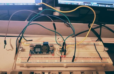

My 6N138's finally came in, now I just have to wait for the resistors I ordered to finally show up.
I hate living here, there's nowhere in town I can buy this stuff from and shipping always takes forever.
    246.47 KiB
    1357 views
    ALMOST COMPLETE!!

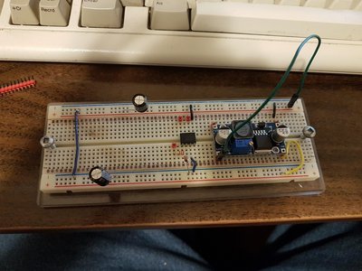

got some resistors from a friend. I finished wiring up everything according to the diagram I made on the first page of this thread, however it doesn't appear to be receiving valid MIDI data.
I'm a totally newb when it comes to this stuff, can someone familiar with this stuff take a look over my diagram and see If I missed something?
EDIT: I managed to find the error. The one of the ground connections on the 6n138 needed to be connected to the midi -data line (Midi pin 5). I need to figure out which pin this corresponds to on the wavetable header. I guess it's time to pull my 486 out of storage... (my AWE64 Gold doesn't have a wavetable header)
This also means that TTYMidi is working now. ( I still need to add a config option for it though)

My rough breadboard prototype is testing and working (and ready for some Tenticle Grape 😈 ). Github was updated to include the tty scripts. This should also in theory work with the softmpu program when configured for serial out.
I'll be sure to update the wiring schematics to include the fixes I've made to the design when I get back from LTX (next week)
Looks like I BARELY met my deadline for getting this working by then. I honestly didn't think I'd be able to get it all done in time. 😊 😊 😊
