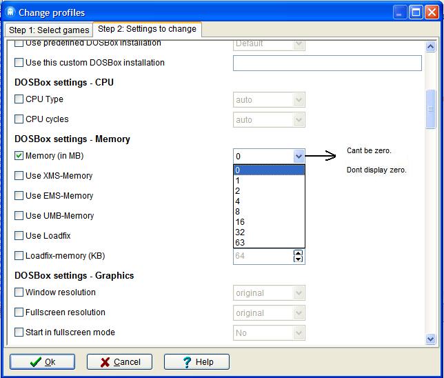

Reply 888 of 2291, by sst
Hi, ...
I use your = D-Fend Reloaded, v0.8 "D-Fend Reloaded PortableApps package".
The "D-Fend Reloaded PortableApps package" v0.8, dont have the sample rate, problem.
Memory size cant be zero.
But i have a "0 = zero" memory option.
See file included.
Sylvain St-Amand (sst)

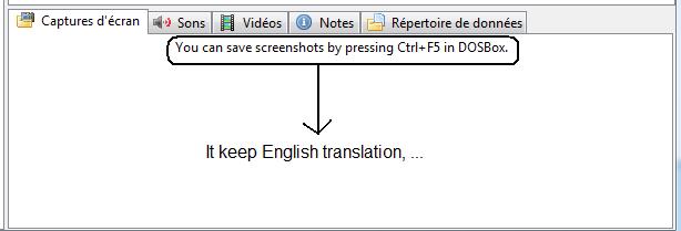

Reply 896 of 2291, by sst
Hi, ... Alexander
I use your = D-Fend Reloaded, v0.8.1.Rc1, "D-Fend Reloaded PortableApps package".
"Screenshots.Info=", have a not translated bug.
Screenshots.Info=Vous pouvez sauvegarder des captures d'écran en pressant Ctrl+F5 dans DOSBox.
See ScreenShot, ...
Reply 897 of 2291, by Neville
That text is translated in other language files, such as Spanish:
I'd say it's a bug in the French translation file. There are many lines to transalte and it's easy to miss something. Whenever I update the Spanish file I often end up fixing typos and unstranslated bits I missed.
Reply 898 of 2291, by sst
Hi, ...
>>> From : sst […]
>>> From : sst
See ScreenShot, ...
>>> From : Neville […]
>>> From : Neville
user image
>>> Respond = I confirm, that there no missing line(s), in the translation file "French Canada.ini" and "French.ini".
(Look below, to a clear respond, ...)
The English text, only do that each time D-Fend Reloaded start. After all data is loaded, no translation text problem, of the screenshot section = it mean that is in French, French Canada.
The bug is not inside, translation file(s). It's a bug of, not use of the translation, of the line "Screenshots.Info=", when starting the software. After all configurations game file loaded, the text (in the screenshot section, like the screenshot is in French).
Please try, with > 200 games. (With only 1 game, it's displayed to fast to see that bug)
I have made, an other sceenshot, ... See the screenshot, ...
