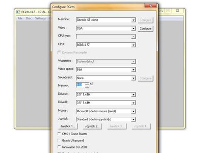

Good morning everyone,
I've got a little issue with PCem.
- I'm running it with a generic XT PC clone setting.
For some reason the maximum memory is limited to 640 KiB.
The video system is set to CGA, so there should be enough space to allow
for 704 KB or even 736 KB of conventional memory.
Still, I can not figure how to apply that setting.
Manually entering 704 seemed to work at first glance, but when I click "OK"
and afterwards come back to settings dialog, the selection is back to 640.
What did I do wrong ?

Because it's the highest supported in a generic XT clone.

Ah, okay, I didn't know that, sorry. I choosed the generic type, because I assumed that
this famous anonymous XT BIOS would be smarter than the normal XT BIOS.
Anyway, my knowlegde about XT machines is a bit sketchy. 😅
I believe I did read that the IBM 5150 determined the total amount of random access memory
via DIP switch settings, while the IBM 5160 was a bit smarter already and counted the actual memory.
So could it work, by any chance, if I select the IBM 5160 model in PCEm ?
I mean, hardware-wise, 640KiB never was the true limit of any PC model,
since even then it was possible to exchange 64K chips with 256K chips.
The main thing was, as far as I know, that the additional memory was contiguous.
(Btw, sometime ago, I read something about an ancient mod for these old IBMs.
Back in time, people did exchange/modify some of the address decoders (U4?).
Another trick was to use the sockets meant to be used for the ROM BASIC for additional RAM.
I believe the old terminology of that extra memory was High Memory, not to be confused with the HMA.)
