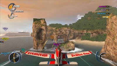

So I tested Sine Mora again, a game which only game me a black screen earlier and it suddenly was working. Confused I checked if resolution forcing and MSAA worked (resolution forcing doesn't, no idea about MSAA), it didn't and gave me the same black screen problem. Then I reset the settings to what I thought were safe defaults, no resolution forcing and no MSAA and tried again, suddenly black screen again.
Yeah apparently I thought "MSAA: Off" was a safe option, but apparently some games don't like that and needs it set to "MSAA: App driven" Among them, SkyDrift, which I thought wasn't working, but it is, sort of:
510.31 KiB
2912 views
Yeah... the trees seem to have a problem with their texture transparency.

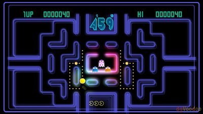

Pac-Man Musem: Pac-Man Championship Edition works in WIP59 (is broken in WIP58):

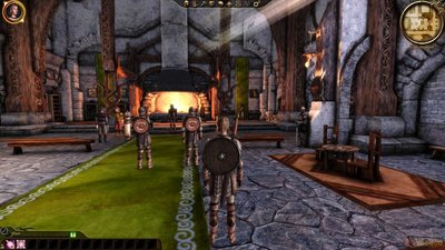

Subtle bug in lightning in Dragon Age Origins. In the start of the area walk around while looking at the shields hanging on the wall and they'll occasionally get shadows they shouldn't have:
539.47 KiB
2840 views

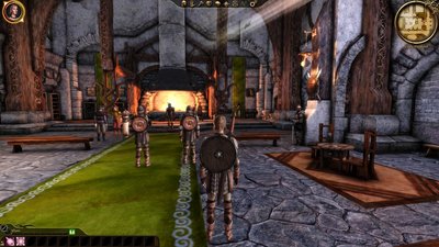

Native for comparison:
539.15 KiB
2840 views
