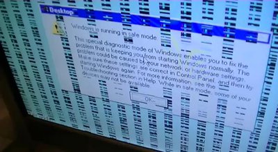

My new video card arrived and I installed it...
The attachment PHTO00075.JPG is no longer available
RAM I am guessing. I don't think returning the board is worth it and I have neither the tools nor the skill to work on the chips... Suppose that as it doesn't work anyway I could just flux the hell out of it and try regardless.
