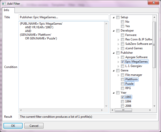

I love this App, but is there anyway to change the filters? I would love if there was a way to have them filtered either tree or tabs since this data is downloaded from Mobi it should not that to hard right? It is cumbersome to highlight and create a filter then try to add games to that filter later on...
Other than it is a really great app, fix the filters and i can leave d-fend reloaded finally 😀
Reply 992 of 2169, by rcblanke
Yeah, yeah..
The attachment filter.png is no longer available
Reply 993 of 2169, by rcblanke
.. And here's another update, test build 0.76d:
* Implemented another way to create a profiles filter; by selecting one (or more) category value(s) in the tree on the right side of the filter creation dialog (as shown in the image above). You can use the checkbox in front of a category value to make the value required; non-checked items will be OR-ed together in the filter condition. Adjusting the tree selection(s) will instantly update the filter condition, and consequently the 'Result' text-field. Note that some values can be expanded one more level deeper, in which the individual words that make up the value can be selected. For example, the value 'Action, Adventure' in the category 'Genre' will have the subitems 'Action' and 'Adventure'. Selecting one of these items will create a 'Genre LIKE %' subcondition, as to filter on any genre with the substring 'Action' or 'Adventure' in it.

There is an issues with the filter generation logic. If multiple options are selected within a group it generates a filter like...
YR.YEAR='1980'
AND YR.YEAR='1985'
...but since a title can't have multiple year values, that filter actually selects nothing. You should be using "OR" instead at least for inner group items (i.e. "AND" groups, but "OR" selections within a group.
