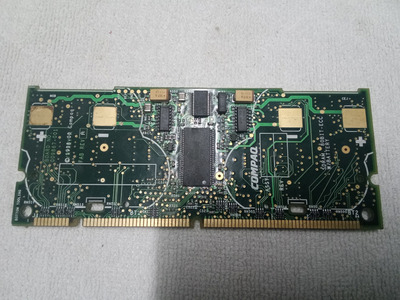

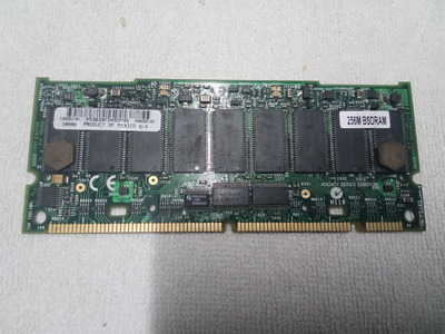

I found at a recycling center some strange computer parts and I would like to ask the community if you know what this are...
This first one is some kinf of SDRAM but seems to can get a battery attached on the back ...
It is from Compaq so.... server ?
Can I it be used on normal PC ? will it explode ? 😀

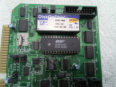

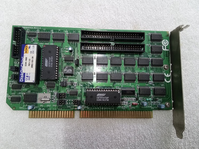

This second one seems to be an ISA card... industrial ?
I would think it is some recording card for security cameras ? I have no idea
I thought it was an IDE controller card but those are not IDE connectors 🤣

Probably ECC SDRAM. It doesn't work in boards that don't support ECC.

Looks like a 50pin SCSI drive controller. Also have a disc on chip that used to be a storage solution mostly on embedded systems.

the RAM is from a RAID controller.

RandomStranger wrote on 2024-04-24, 17:28:
Probably ECC SDRAM. It doesn't work in boards that don't support ECC.[/quote]
ECC SDRAM works fine in boards that don't support ECC, just like parity SIMMs work in non-parity boards, you just don't get the error detection/correction.
You're probably thinking of registered vs unbuffered. Registered DIMMs won't work on boards designed for unbuffered and vice versa. A lot of ECC DIMMs are also registered, and the vast majority of registered DIMMs also use ECC, but it's the registers, not the ECC, that breaks compatibility.
However as has already been pointed out, this is a custom unit from a RAID controller.
Don't think it's SCSI, for starters it has "MATRIX CONTROL" next to it. Also there's nothing on that card that looks like a SCSI controller, and not enough discrete logic to do it with that.
The sticker on the DiskOnChip (which is on ISA bus so by default basically IDE) says "EDR-1600", which leads me to this:
http://www.securitex.com.sg/Securitex%20Digit … 0Everfocus.html
Looks like a custom card from a security system. Those 50p connectors are for some custom I/O to control the 16 channel video matrix it can display.
Without the rest of the system, what you have there is a rather large ISA DiskOnChip interface, i.e. an SSD 😉

So basically useless stuff since I dont have a securitex surveillance system and a RAID controller loool 😀

Reply 8 of 8, by Nunoalex
pentiumspeed wrote on 2024-04-24, 22:33:
memory module is from a storage controller by compaq.
Cheers,
Thanx !
WELL good news 😀
They really are memory modules and they ran fine on a normal consumer Slot 1 motherboard with a Pentium III like a normal SDRAM module 😀
And even with some blinking lights hehehe
