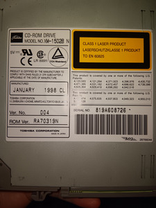

Can anyone confirm that this drive will work under Dos?
I have tried the 'toscdrom.sys' driver from this link, but MSCDEX will not load it, which makes me wonder if it's a corrupt/broken file.
https://www.vogons.org/viewtopic.php?f=61&t=94887&p=1253885&hilit=460cdt%20driver#p1253885
The CD-ROM works fine under the windows 95 gui, though not in the dos mode. It also works under the 98 gui and 2000. This is a problem as I have a few CD games that refuse to run in windows mode.
I have looked at what appears to be the original driver cd-rom for my laptop:
https://archive.org/details/460back
There is no driver for the cd-rom on it, despite having dos/w3.x drivers for the sound/video/modem etc.
The photo below is a snap I've taken of my drive which seems to be stock. It's a selectbay version of the Toshiba xm-1502b-n, and I presume the 'n' prefix means 'notebook' or such.

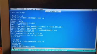

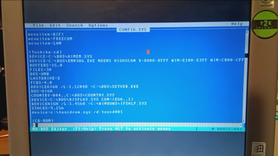

What do your config.sys and autoexec.bat look like?
Yes, I chose the 10x selectbay option from the driver install menu, which I believe is what the xm-1502b n is.
My config.sys and autoexec.bat are in the attached screenshots:
I manage a pot-pourri of video matter...

Hmm, it seems mine is XM-1502B S. May 1998, ver 000, ROM RA71013S. Never noticed the "S" before. Works like a charm with oakcdrom.sys.

I've got a recovery disk from the 445CDT which has the same TOSCDROM.SYS as the 10x version - Toshiba CD-ROM Device Driver (ATAPI) Version 3.03
Checking the 10x file from the toscdrom package it has the same CRC / SHA checksums so it's the same and the file in the toscdrom.exe is not corrupted.
The recovery disk is attached for reference though I understand you can't use the floppy right now 😒
Just pulled out a 460CDT with the same CD-ROM drive as yours (XM-1502B N) with Windows 98 SE installed. Tested with this TOSCDROM.SYS and these settings:
Config.sys: DEVICE=C:\TOSCDROM.SYS /D:TOSCD001
Autoexec.bat: MSCDEX /D:TOSCD001
Note that there's no path specified so it should be using MSCDEX in the Windows directory, under "command" I think.
Booted up to command prompt only and the CD driver works fine and could read my Windows 98 test CD from DOS.
I wonder if the MSCDEX file you're loading from the DOS directory isn't working with the DOS version you're booting into?
Or perhaps an inclusion / setting in EMM386 is using some memory space needed for the CD-ROM drive, a longshot but it's something I faced getting PCMCIA working in DOS. Could try temporarily removing some of the EMM386 options.

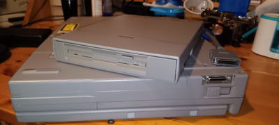

Thank you for your great efforts in verifying the software and uploading the reference materials. As you can see from my last post, it turns out to be a bios setting causing the trouble.
My floppy drive isn't the internal selectbay type, though rather the external box type with the cable that plugs into a small socket under the power button. And I too reckon the belt is dead, as it makes a slow wiring noise when trying to access the diskette.

Regarding the floppy drive - that's an EME279 drive and it also needs a new belt. It's pretty easy to replace the belt on that compared to the W1D and it's a much more reliable drive in my experience.
