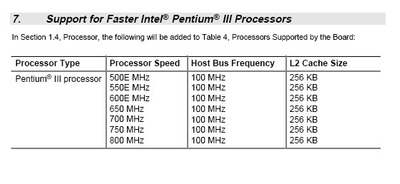

According to the last Prod Spec update 011, the following P3 processors are supported: see picture.
The P3 800Mhz @ 100mhz fsb has TDP of 20.8W or about 12amps and is supported.

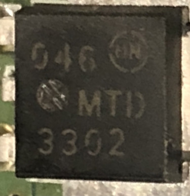

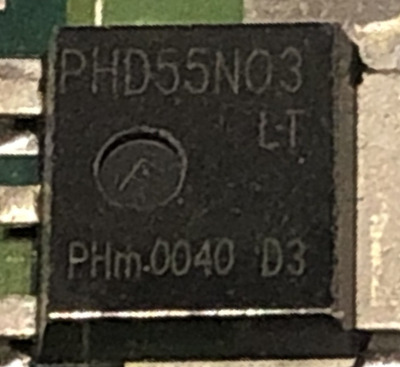

Can you post us the 3 Mosfet numbers ?
That would give a better clue if it is their max current or the circuits design. Thanks
The one by the bottom choke is:
266.27 KiB
313 views
The two on either side of the top choke are both:
221.6 KiB
313 views
Reply 3 of 11, by Horun
Ok it is a design issue, those FET's can handle 30+amps even at 100C temps. The MTD3302 datasheet gives some info on heatsink or board mount, and board mount w/o heatsink they have very limited current capability of about 8A each. So in a bridge design be 16A. Curious what value are those 8 caps ? Comparing to a simple Asus P2B-F with triple+ the coil windings and 15 x 1000mf caps the SU810 cpu vrm looks very wimpy in my opinion.
