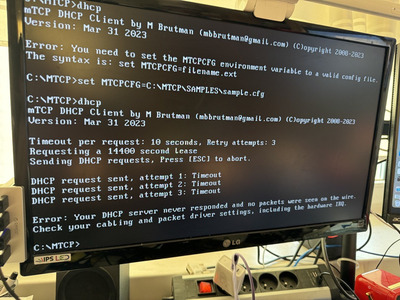

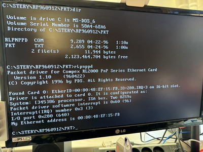

On DOS packet driver detects network card (and its MAC adres) but when i try to use DHCP from mTCP pack there were only timeout.

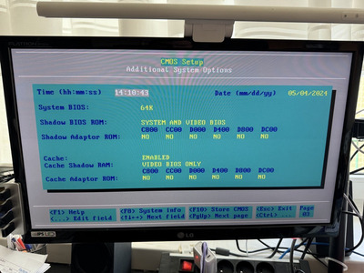

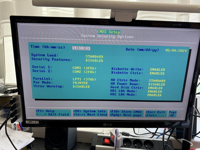

This is my BIOS config, maybe there is a problem in BIOS?

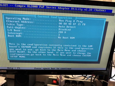

This is card configuration utility

This is packet driver

This is DHCP from mtcp

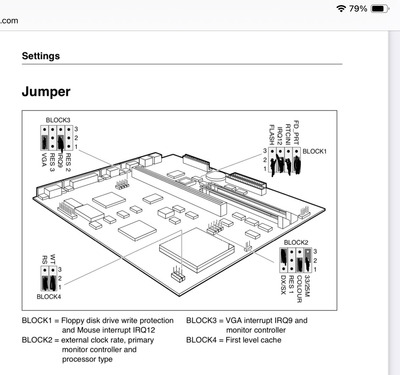

Does it have any way to set ISA bus speed? If it's on a cpuclk/3 setting it might be too fast.
edit: nevermind, looks like you must have a DX2-50 as only 25 and 33 bus speeds listed. If it doesn't work on 25Mhz setting it's likely not a speed problem.... unless it's set at clk/8 and wayyyy too slow.
Reply 6 of 25, by kepak
BitWrangler wrote on 2024-05-04, 17:53:
My jumpers looks like this, I switch jumper to 33MHz and I overclock CPU to 66MHz (but I revert back).
143.38 KiB
358 views

If you have COM2 enabled then IRQ3 will be shared with the NIC if you set it at IRQ3......
download/file.php?id=192249&mode=view
Try disabling COM2 or move the NIC to an un-used IRQ.....
Reply 8 of 25, by kepak
Horun wrote on 2024-05-04, 18:21:
I turn off the COM1, COM2 and LPT1 - no effect
I switch IRQ to 5 in card utility - no effect
This kind of things i tried many times before I bought NIC #2 and NIC #3
