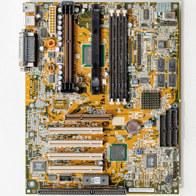

I have an HP 8570C that has the ASUS P2B-VE running a P3 450. (HP Condor 1 https://theretroweb.com/motherboards/s/hp-condor-1)
Since it has a 3.3v AGP slot I realize its pretty limited in what it can take but I was hoping I'd be able to use the universal cards I already own. I've tried an MSI MX 440 (8895-010) and a generic FX 5700, neither worked. I get one long beep and two short beeps with no video on the card or internal graphics. I'm also realizing even if they did work the PSU is only 160W which I'd guess probably isn't enough.
Before I spend money on another card I figured I'd check here for recommendations. I know the P3 450 is my bottleneck but I was hoping to utilize the AGP slot. 🙃

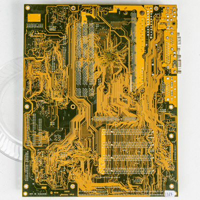

Reply 2 of 10, by rasz_pl
Interesting abomination, ZX, AGP slot and Rage Turbo AGP. Hopefully Rage is on PCI bus, but suspiciously a lot of tracks from it go to AGP slot suggesting it needs to be hard disabled first. Have you played with VEN_DIS jumper?

Reply 7 of 10, by jebb
rasz_pl wrote on 2024-05-05, 12:33:
This was it! I had no idea those jumpers existed and probably would have never noticed. I set both VEN_DIS and VGA-INT to disabled and after clearing the CMOS it was able to boot with the cards I mentioned earlier.

I was considering this upgrade but wasn't really sure if it would be compatible. I also noticed the pins for the FSB clock are missing 🤣. You can see it in the pic rasz_pl posted.
