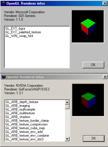

Try downloading and running the Open_GL Renderer program here. Run it to see what results you get.
    opengl_info.exe
    33.5 KiB
    236 downloads
Reply 13 of 29, by Nicht Sehr Gut
If you get results like the window on top, your software GL renderer is considered the default. It should look more like the window at the bottom (with a GF4 being identified).
