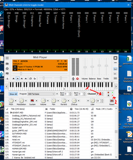

I have another file that does not play quite correctly but no loud instruments, it is ADVENT.MID.
I have attached it and a recording of it to this post. I had to reduce the bit rate a bit on this one and make it variable as it was over the 5Mb limit.
Some of the instruments sound odd or off is all I can describe it as.

Reply 46 of 57, by Falcosoft
Poot36 wrote on 2025-03-23, 01:15:
That is good to know. I have another file that does not play quite correctly but no loud instruments, it is ADVENT.MID. I have […]
This time I do not see any obviously suspicious Midi messages so first you should try to identify the problematic channel(s). You can use Midi player for this. On the right hand side of the player you can find the Channel selector and the Mute button. You should mute the channels one by one until the problematic sound stops. My first tip is channel 6 Program 88 (Fantasia).
150.17 KiB
438 views
Website, Facebook, Youtube

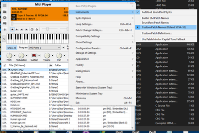

Reply 47 of 57, by Poot36
Ok, I have done some testing and for some reason channel 6 Program 88 is listed on my setup as New Age Syn Pad. Is it possible I have the MIDI player program set up wrong and that could be part of the issue? I also found that if I increase the volume in the MIDI player software I can hear more instruments playing for some reason.
I also found out that my home made 1/4" to 3.5mm headphone adapter was starting to fail so I suspect my previous recording my not have been as correct as it should be.
Reply 48 of 57, by Falcosoft
Poot36 wrote on 2025-03-23, 23:06:
No, it's not a serious problem. New Age Syn Pad is just the GM name of the same istrument. But of course you can set Midi Player to display the GS name but it does not change the sound:
102.6 KiB
408 views
BTW, you should play back the Midi file at maximum volume since it seems lower than max. volume can result in problems on your synth.
