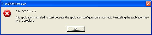

rcblanke wrote:
@kronuz: I can live with your temporary(?) solution most certainly! Unfortunately, your latest build displays the dreaded "This application has failed to start because the application configuration is incorrect" message again...
That's interesting... my latest build mostly changed as the cvs changed, perhaps there were some issues at the time I checked out the cvs... I'm updating now.

Kronuz wrote:
That's interesting... my latest build mostly changed as the cvs changed, perhaps there were some issues at the time I checked ou […]
[edit]
Not really, it doesn't look like it was a cvs thing, what's exactly the message displayed and when?
Happens to me too(BTW, great patch, thanks.):
    16.45 KiB
    1154 views
    The error message.
Reply 166 of 227, by Kronuz
hmm... it seems it has something to do with the compiler... I'll have to check that later 🙁
Anyway, gulikoza's cvs build now has my patch (hopefuly that one does work for all of you, as he has a lot more experience compiling DOSBox)

Reply 171 of 227, by Kronuz
@Og and rcblanke: I've found what the problem is, I was linking dynamically (again 😜) sorry about that.
@augnober: I'm checking the Hardware 3x scaler right now, I hadn't checked it since gulikoza added it... I already found a small bug so that might be it.
