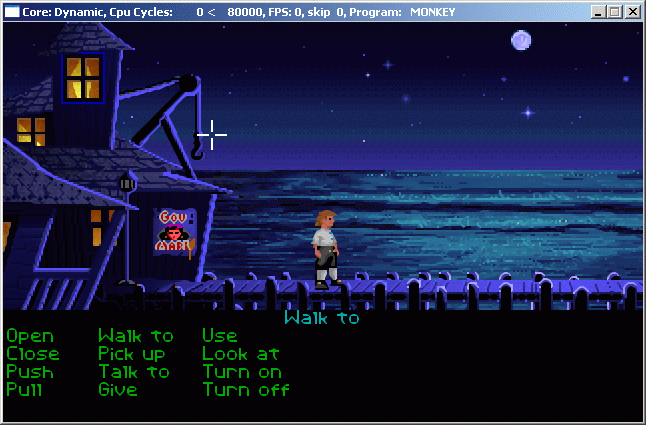

From my latest test comparing IQ between different output modes:
1. OpenGLHQ (best) (# of unique colors 7,078)
2. Direct3d (# of unique colors 505)
2. OpenGLNB (# of unique colors 504)
2. Surface (# of unique colors 505)
3. Overlay (# of unique colors 10,327)
4. ddraw (# of unique colors 13,869)
4. opengl (worst) (# of unique colors 13,934)
The ones with the same # are AFAIK the same image quality.
So for straight CVS it's good that "Surface" is used since that's the "best" as far as original DOS image quality graphics.
Of course if you like blurriness then the output modes that are worse than surface will work and not be as resource intensive as using a scaler.
All screen caps taken using "ALT+Printscreen", saving as .BMP with Irfanview.
Tested using "Normal2x" (Haven't gone through the scalers yet...just default config)
Used Monkey Island 1, only took pic when character had stopped walking in the initial part of the game.
Taken with Windows XP, Directx 9c, Windows XP Pro, ATI X800 with Catalyst 5.8 drivers.
gulikoza's build, Dec 2 2005

I noticed those screenshots were taken with aspect correction off, making everything look squished. I was thinking that it might actually be meaningful to compare the different output modes with aspect correction on to see which ones handle it better than the others.
Reply 14 of 15, by DosFreak
Nah, I'd rather have it "squished" (original res) instead of extra length. 😉 (MI1 uses 320x200, aspect stretches to 320x240)
With 2x it's 640x400 or 640x480.

Reply 15 of 15, by HunterZ
Yes the original res is 320x200, but it was meant to be viewed full-screen at a 4:3 aspect ratio. Without performing aspect ratio correction (strecthing it to a multiple of 320x240) you won't see things in their intended proportions unless you run in a resolution that is a multiple of 320x200.
