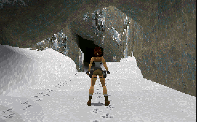

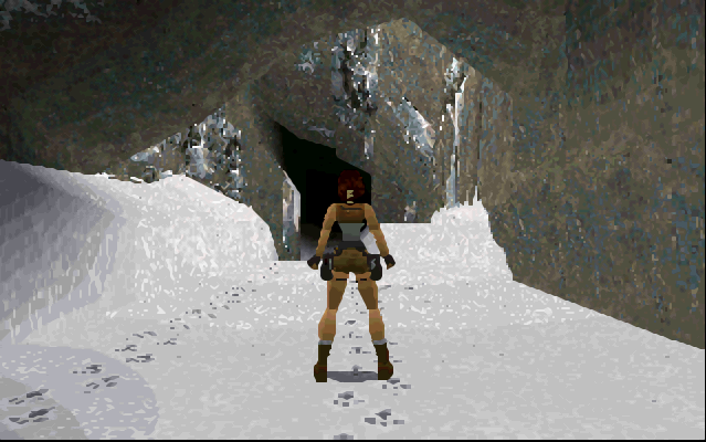

The new hq2x code (compared to old moe's patch) looks worse in some games. It looks almost the same as normal2x. I vaguely remember already debugging hq2x for tomb rider - it was some problem with palette changes and recalculating hq2x tables but the new code does this a bit differently afaik...
Screenshots taken with today's clean cvs (newhq2x and normal2x) and an older build with old hq2x code (25.1.2006).
    72.17 KiB
    3574 views
    Normal2x
    161.74 KiB
    3574 views
    New HQ2X
    123.01 KiB
    3574 views
    Old HQ2X
