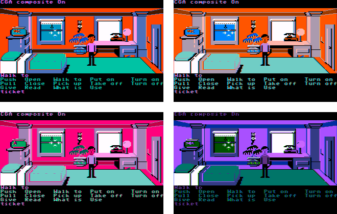

Carrying over some relevant discussion from Re: An old game (Zak McKracken and the Alien Mindbenders) has display problem ...
Anyone care to guess what's up with Zak McKracken's composite CGA mode? It uses mode 4, but the colors don't make much sense, on any of the machines discussed so far; see attachments for comparison. By extension this also applies to Maniac Mansion (and to the enhanced versions of both games).
I guess new CGA comes closer than the others, but it's still a stretch... of course, it's entirely possible that composite color support was more of an afterthought at that point, and they never really bothered to make it look decent. Don't know why they didn't just use mode 6 -- that palette would have been a better fit, as demonstrated by Sierra.
    36.16 KiB
    2120 views
    top: old CGA, new CGA
    bottom: Tandy, PCjr

Reply 507 of 753, by Great Hierophant
The composite colors do make some kind of sense in Zak. They managed to get Zak's skin to look a flesh color with CGA and sky and water are blue, but not to make the leaves on his plant green or the wooded objects brown. Only the solid black, white and cyan colors make sense in the Tandy and PCjr. modes.
Reply 509 of 753, by VileR
Now that I actually look at the patterns, that makes sense - no use in testing these games, then. Good to know.

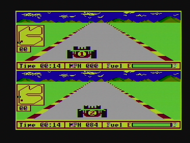

Pitstop II has always bugged me on CGA; it uses green foreground color instead of white, and the results on CGA are a more or less useless blue/green tinted image. On the PCjr however, it ends up as something much more useful! (attached image)

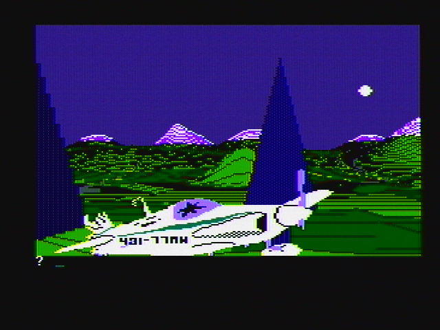

Wilderness: A Survival Adventure I'm not sure about; the dithering patterns lead to some reasonable colors on PCjr (more so than CGA) so it looks intentional. Either way I find it to be the best looking option for the game.
    347.59 KiB
    1565 views
    Wilderness captured on PCjr
    370.16 KiB
    1565 views
    Pitstop II captured on PCjr

The blue trees for PCjr don't seem intentional, unless they're supposed to be blue spruces 😀 The Wilderness shots on Mobygames look like RGB rather than composite, so they don't provide a good CGA versus PCjr comparison.

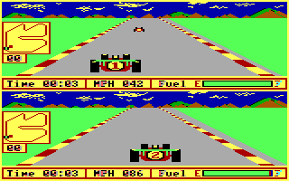

Nice find - on top of that one-pixel shift, it also seems to change the hi-res foreground color to 9 (blue), at least when I try with machine=pcjr. I'll have to check and see how well that matches your images.
Definitely looks heaps better than CGA, though in this case no thanks to artifacting... it just seems to be using 16 solid colors: now that I tried it in DOSBox with machine=pcjr, if you hit "1" on the monitor select screen you get mode 8, aka 160x200 in 16 colors (see attached for a straight RGB screenshot).
This looks nice enough in both RGB and composite, which makes option "2" kinda useless on the PCjr. Never knew that the game supported this - there are no PCjr screenshots on MG at any rate, so I guess I'll go ahead and submit some now. :)
    3.02 KiB
    1428 views
    PCjr Pitstop II, 160x200x16
Reply 516 of 753, by Servo
Ah, missed that with Pitstop II...when I made the capture I also checked in DOSBox to see what the RGB looked like and I got the same result as CGA, but I was in a hurry and must have forgotten to change machine to pcjr or something; I just tried again now and it worked. Very neat, I didn't know this was supported either. Still makes me wonder what in the world they were thinking with the CGA composite version.
Reply 518 of 753, by VileR
Tested two versions from Retrograde: the booter image behaves the same with pcjr as with cga (i.e. sets mode 6 if you pick display option #1); the EXE conversion sets mode 8 when machine=pcjr, and that's the one I checked first (and evidently Servo as well).
Both will use mode 4 if you pick display option #2. It's quite possible that there was a different / updated version that supported PCjr graphics, and the exe was sourced from that. The display selection screen doesn't make too much sense with that in mind, but given the colors in the composite CGA version, making sense evidently wasn't a priority.
