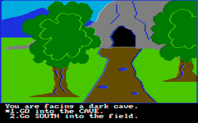

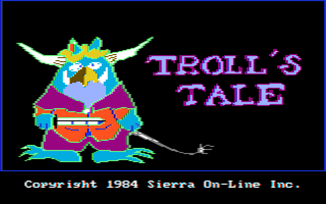

I use those nice little programs since a few months, and since the discussion came to Troll's Tale I wanted to add some screenshots.
The same scenes as in the attachments on genuine composite (MobyGames):
#1
#2
The only thing that annoys me is that the change is permanent. Even when I restart DOSBox, it gives me the composite mode.

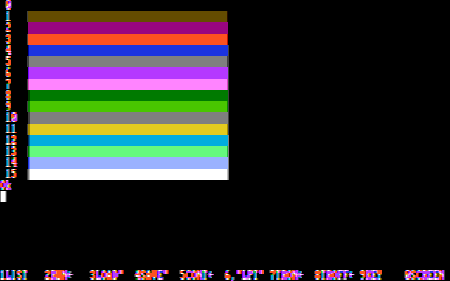

This composite mode is pretty interesting. I've downloaded the COMPCGA3.EXE program and tried some stuff. Here is a GW-BASIC program to print 15 patterns in screen mode 640*200*2, see screenshots below for the results.
10 SCREEN 2:CLS
20 Y = 0: YSIZE = 8
30 FOR COUNT = 0 TO 15
40 LOCATE COUNT+1, 1
50 PRINT COUNT
60 GOSUB 100
70 Y = Y + YSIZE
80 NEXT COUNT
90 END
100 FOR X = 40 TO 320 STEP 4
110 IF ((COUNT AND 1) <> 0) THEN LINE (X+0, Y)-(X+0, Y+YSIZE-1)
120 IF ((COUNT AND 2) <> 0) THEN LINE (X+1, Y)-(X+1, Y+YSIZE-1)
130 IF ((COUNT AND 4) <> 0) THEN LINE (X+2, Y)-(X+2, Y+YSIZE-1)
140 IF ((COUNT AND 8) <> 0) THEN LINE (X+3, Y)-(X+3, Y+YSIZE-1)
150 NEXT X
160 RETURN
    2.66 KiB
    4212 views
    3.34 KiB
    4212 views

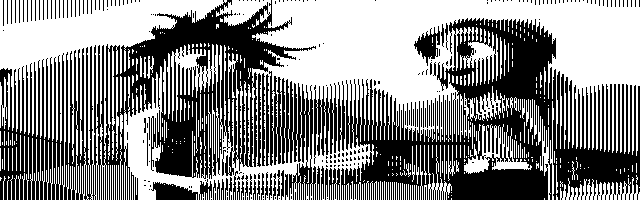

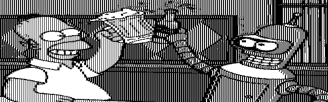

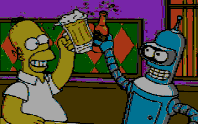

I also used the resulting colors as a color palette in Paint Shop Pro in windows. I converted 2 pictures to use these CGA composite colors, and load them in PC-Paint in dosbox. See conveted gif files, and screenshots in attachement.
    9.22 KiB
    4211 views
    original gif file, load in Pc-paint or other gif viewer
    8.22 KiB
    4211 views
    10.27 KiB
    4211 views
    screenshot of composite cga result
    9.8 KiB
    4211 views
