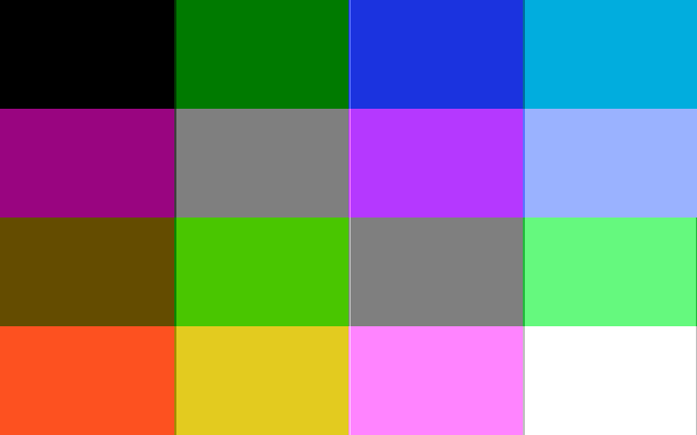

re: Tandy -
reenigne wrote:
So just try both and use whichever one gives the right set of chroma colours.
Thanks - the second one did it; shifting the hue adjust 135 degrees retains the solid cyan and magenta (see image). Assuming that the Tandy 1000 didn't fiddle with anything else, I guess the rest of the colors (chroma+artifact) should also be considered correct. They don't line up with NRS's Tandy results; but at this point, I'd say the only way to prove reliability would be to test this on an actual Tandy 1000.
    3.61 KiB
    2903 views

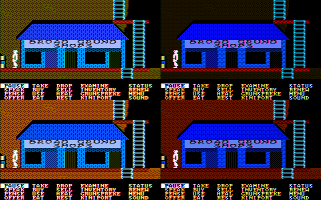

Great Hierophant wrote:
From reviewing the screenshots above, I would suggest that most developers or porters had the early cards in mind when they designed their graphics for composite video. Shamus and Jungle Hunt are almost too dark to play, and even the tree in Below the Root seems somewhat more appropriate in more orangish brown than the reddish brown. However, the clothing of Sun Zu in The Ancient Art of War in the darker screenshot matches his clothing in the EGA screenshot.
The images in the last set I posted were all generated with the "new CGA" code - gamma is the only difference between the light and dark variations. Gamma correction applies to the "old CGA" code as well.
See the attached comparison for Below The Root:
first row = old CGA
second row = new CGA
left column = gamma correction off
right column = gamma correction on
    22.33 KiB
    2541 views

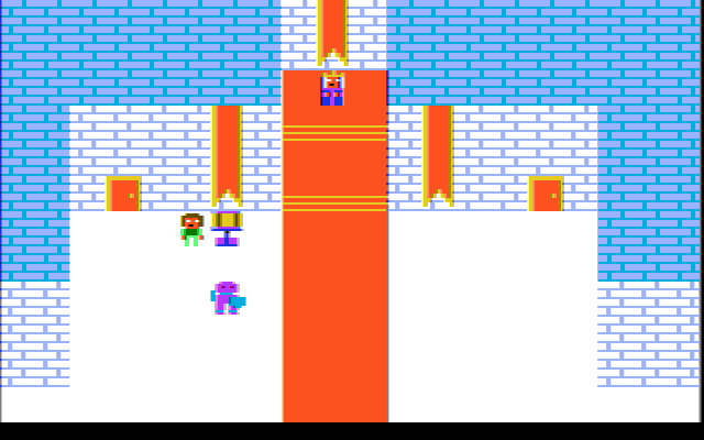

Reply 176 of 758, by nikiniki
I like the last picture because it's most like screen 3 on PCjr in Basic.
I'm working on a game with CGA Composite in mind.
I want to be sure the colour would be fine with the game.
Since Dosbox has different colour in cga composite, making games like this could be a problem.
    3.1 KiB
    2535 views
