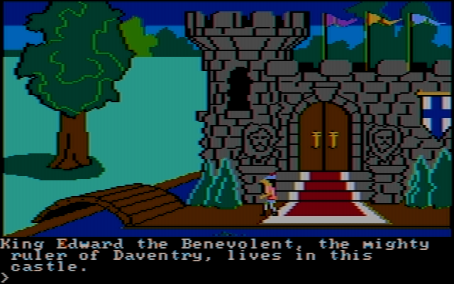

Reply 203 of 758, by NewRisingSun
doing things like using a linear YIQ->RGB transformation matrix, convolving with a linear filter kernel for band-limiting the Y, I and Q signals
No, that's entirely correct, because YIQ to RGB transformation as well as the band-limiting is even in theory meant to apply to electrical signals, not to light. Unlike color correction, which in theory is meant to apply to light, not electrical signals.
I'm interested to see what difference it makes doing the conversion from NTSC RGB to 709 RGB in linear vs gamma corrected colour space - the conversion matrix is not enormously far from the identity matrix so the difference might not be very noticable.
I'll post examples later.
I'm still puzzled as to why doing an extra gamma correction seems to produce results much closer to what I see on my TV connected to my CGA card
Is it brighter or darker on your TV? Remember that American NTSC uses a black level of 7.5% ("setup"), so you need to do this to your RGB values coming from the YIQ-to-RGB matrix as well:
R = (R - 0.075) / (1-0.075)
G = (G - 0.075) / (1-0.075)
B = (B - 0.075) / (1-0.075)
That black level business is found in all NTSC standards documents, whereas that dubious 2.5/2.2 gamma adjustment business violates the standards, since NTSC and sRGB are supposed to use similar gammas.
And another thing that no one has taken note of so far: real television sets usually do some form of automatic gain control (AGC) on the signal, to compensate for weak signals when receiving via antenna. This is a major source of variation between TV sets when dealing with signals like the CGA's that output somewhat non-standard video levels, because they tend to confuse the AGC circuits.

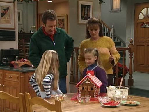

Earlier I promised to upload example images demonstrating how properly done color correction from NTSC to sRGB differs from approximately done, that is, applying a correction matrix on non-linear signals. The matrix for the proper correction of linear signals is the one cited earlier:
	      Rs	      Gs      	Bs
Rt= 1.5073 -0.3725 -0.0832
Gt= -0.0275 0.9350 0.0670
Bt= -0.0272 -0.0401 1.1677
Whereas the one for the nonlinear signals, assuming a gamma of 1/0.45 and minimizing color errors for CIE x/y: 0.444/0.399 and 0.309/0.494:
	     Rs	      Gs	      Bs
Rt= 1.5164 -0.4945 -0.0219
Rt= -0.0372 0.9571 0.0802
Rt= -0.0192 -0.0309 1.0500
This corresponds to a NTSC decoder matrix in polar coordinate form of:
R-Y: gain=2.016 angle=81.5°
G-Y: gain=0.668 angle=244.8°
B-Y: gain=2.276 angle=-0.2°
First, a set of "real-life" images from a television camera. First picture is the original uncorrected picture, which doesn't necessarily look ugly, but the faces are somewhat pale. Second is the exact correction from linear signals. Third is the approximation when using non-linear signals. As you can see, both correction methods yield almost identical results in most areas except the very saturated reds, which become too bright in the approximation.
    261.95 KiB
    1737 views
    approximate correction using non-linear signals
    273.6 KiB
    1736 views
    exact correction using linear signals
    258.75 KiB
    1736 views
    uncorrected image

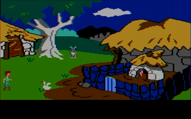

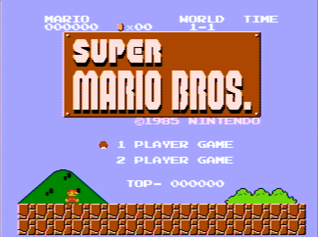

Reply 205 of 758, by NewRisingSun

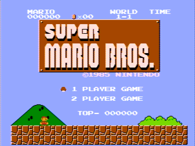

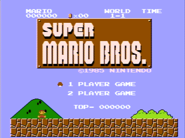

Second, a set of images from a video game.
    70.66 KiB
    1713 views
    69.04 KiB
    1713 views
    exact correction
    70.22 KiB
    1713 views
    uncorrected image

Thinking about it, I'm in favour of using the theoretical ideal NTSC-to-709 matrix since (in combination with the palette method) it's not too slow. I think that was NewRisingSun's preference too.
Again, it depends on what your goal is. If you do it that way, you can always claim that you are following the standard as closely as possible.
But it won't necessarily make for particularly pretty colors. In particularly, people will continue to pester the developers about brown being too greenish or red being too pinkish, depending on the hue setting. The most user-friendly approach would be to screw the standard and just make up a decoding matrix that produces pretty colors. Such a matrix would be in polar coordinate form:
R-Y: gain=2.00 angle=120°
G-Y: gain=0.67 angle=260°
B-Y: gain=2.00 angle=-10°

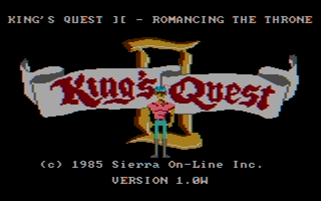

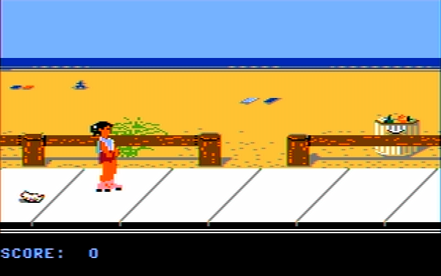

See pictures, all at a hue setting of ±0°. You would not need any fancy non-linear color correction either. That's actually the solution I would now favor, as there are no brownie points to be earned from following a 59-year-old standard as closely as possible.

Reply 218 of 758, by VileR
"Pretty colors" is a rather subjective measure in itself, and if the qresult is cyan-colored grass (KQ1), bluish trees (KQ1, Black Cauldron), pastel-like yellows, etc., then I don't know how effective that would be in fending off user complaints.
Reply 219 of 758, by NewRisingSun
Well, it can still be optimized, of course. 😀 But you notice that the grass in King's Quest is the same color as Graham's pants in King's Quest II, which are cyan in RGB. The booter version of King's Quest translates the same RGB colors differently to composite colors than King's Quest II.

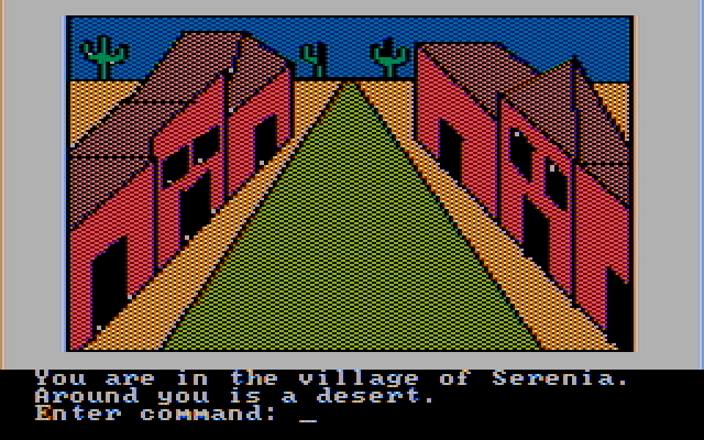

In the meantime, I have noticed that in addition to Microsoft Decathlon, Adventure in Serenia, the IBM PC port of Sierra's The Wizard and the Princess, is somewhat sensitive to the CGA revision used, assuming that I am applying the algorithms correctly.
    21.51 KiB
    1426 views
    with CGA part number 1501981
    22.76 KiB
    1426 views
    with CGA part number 1804472 or 1501486
