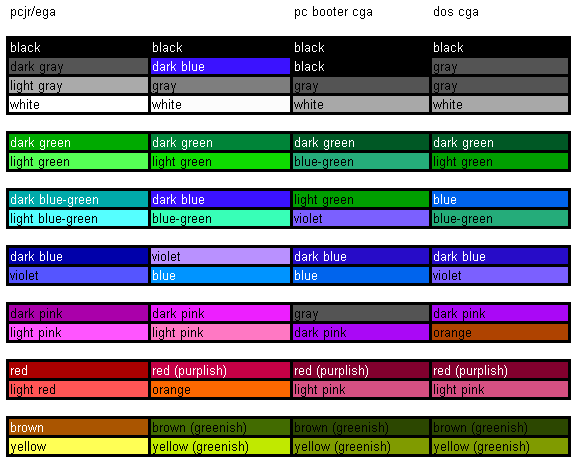

Reply 308 of 758, by robertmo
thanks, edited the story and colors (with the ones used in dosbox from this thread) and also added game examples (pictures) showing all possible colors (they don't display so you have to click them).
This shows how sierra's palette evolved.
PC junior palette was the original for this game and was also adapted to display on cga composite cards. For later version of the game they tried to enhance cga composite although final effects were not very good.
As cga had only one shade of gray thay used black for the darker first, later they used two grays of the same shade for that.
Cga also has no red and light red so they had to use purplish red and light ping for that.
As a result of that they had no light pink so they had to use dark pink instead and gray instead of dark pink. Later they brought back dark red and introduced orange (that was not used before at all) instead of light pink which was not a good idea.
As cga had only one blue-green that could be used for both blue and green items, so they tried to handle is somehow with final result being rather worst of all, as i guess they more tried to reproduce better matching shades of green and blue than matching the actual game items that appeared blue instead of green or green instead of blue as a result.
I think all newer games that appeared already with ega support had new cga palette that was actually worse than the old one used in booters. And these games also used orange as a lighter shade of brown that was using light pink in cga. They shouldn't have made any improvements to cga in my opinion. So the only way to play newer games properly was to use ega.
It looks that with first cga attempt they tried to much colors so that the game looks best. The second attempt looks like they tried to much colors as much as possible without checking how game will look. And as a result it looks as if it was buggy.

Reply 311 of 758, by robertmo
I have added palette transformation used by sierra's Troll's Tale. I guess this one was used before kq1booter. It is using higher intensity. They left pink shades correct but broke light red shade. Different handling of dark gray as dark blue. And a nice mess in the blue/blue-green colors - no wonder this transformation wasn't used long 😉
Don't know what (or even if) Winnie the Pooh in the Hundred Acre Wood is using any transformation as I don't know whether ega/pcjr version of that game existed.
All other sierra games use the last (right most) palette:
Donald Duck's Playground
Mickey's Space Adventure
King's Quest II: Romancing the Throne
King's Quest III: To Heir is Human
The Black Cauldron
Space Quest: Chapter I - The Sarien Encounter
Leisure Suit Larry in the Land of the Lounge Lizards
Mixed-Up Mother Goose
Space Quest II: Chapter II - Vohaul's Revenge
Police Quest: In Pursuit of the Death Angel
Gold Rush!
King's Quest IV: The Perils of Rosella
Manhunter: New York
Manhunter 2: San Francisco
So it looks if anyone wanted to make egalike (or even some pretty) palette he would have to make it for each game separately 😉
    16.69 KiB
    1224 views

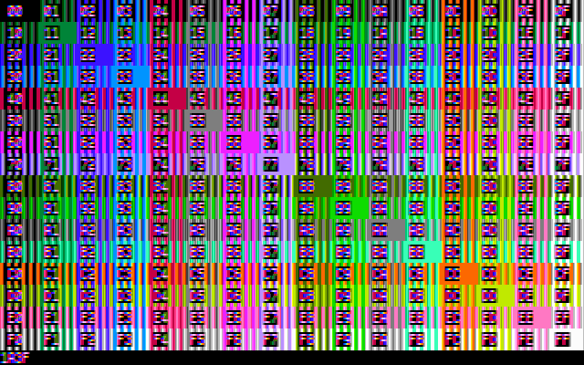

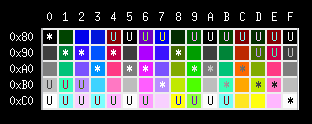

Reply 312 of 758, by VileR
@ ripsaw8080
I went ahead and tested my idea above -
VileRancour wrote:
changing line 246 in vga_other.cpp - double YY = (Ylevel==0) ? Y+(1-Y)*j/4.0 : Y*j/Ylevel; […]
to this -
double YY = (Ylevel==0) ? Y+(1-Y)*j/4.0 : ((j<=Ylevel) ? Y*j/Ylevel : Y+(1-Y)*(j-Ylevel)/(4-Ylevel));
...and yeah, it doesn't work nearly as well as I thought. It does produce smoother luma gradients, and gets rid of the clamping, but the end result is actually worse - see the first image attached: the weird edge transitions are more prominent than before in Decathlon (and elsewhere).
Conclusion: as far as 320x200 modes are concerned, 80 palette entries just aren't enough. Comparing to cga2ntsc output, it seems that the pixel-pairs which show this effect should have a different hue, with luma levels that aren't currently represented.
reenigne wrote:
The palette might be a bit misleading though - because of the way it's constructed for that algorithm, not all the colours in it will actually ever get used by the draw routine. There are fewer ways to make colours with very high or low luma than there are to make colours in the middle, but the palette includes all luma/chroma combinations.
Haven't quote considered this before, but yes, see the last two images attached; there are 28 colors (give or take) that seem to be unused. At least if I trust the output from "16x16x16.exe" in this test suite: http://www.seasip.info/VintagePC/composite.zip - these patterns seem to run the line drawing routine through every possible value.
Am I correct to assume that this would still be the case if we doubled the number of entries to 160 (giving ~56 unused colors)?
Yes. Mapping composite to RGB colors is pretty arbitrary after all, so a universal DOSBox patch can't (and shouldn't try to) cover such a thing. At least you have the PCjr/Tandy/EGA version of these games.
    5.33 KiB
    1177 views
    "*" = the 16 continuous composite colors
    "U" = unused colors (never returned by the linedrawing routine)

Reply 313 of 758, by reenigne
NewRisingSun wrote:
If you use the start of the sync pulse as the reference point, then the shorter sync signal makes no difference (except for choking off the color burst), and horizontal centering will be exactly as in the 40 column mode.
If you use the end of the sync pulse as the reference point, it will make a difference though: since HSYNC is only 10 hchars = 5 lchars long and the shift register is gated by HSYNC, the sync pulse will only be three instead of four lchars long, thereby end earlier and thereby shifting the picture horizontally.
Yep. I just did some experiments and was able to determine that the generated horizontal sync pulse in +HRES mode is only 3 lchars long. The following image was made by using 40-column text mode with +HRES set and border colour 14, which gives a corrupted image and makes the sync pulse visible in the middle of the picture:
