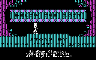

Reply 425 of 753, by VileR
Great Hierophant wrote:
It will give nothing since those registers do not exist in PCjr. That is reengine's program, ask him for something that would work in a Jr.
your last post seemed to suggest that Servo should take pictures of it running on a PCjr, hence my reply. Must have misread or something.

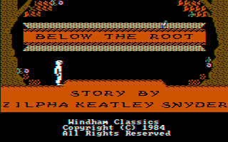

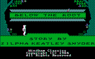

ripsaw8080 wrote:
Below The Root works with machine=pcjr in official releases, but has a problem in SVN when the game calls INT 10h/AH=0Bh/BH=08h/BL=00h. BH=08h is a strange subfunction number, but DOSBox treats it the same as BH=01h, thus selecting palette 0.
There appears to be a bug in INT10_SetColorSelect(). I've attached a patch with a proposed solution, but Hal probably has a better idea.
Thanks - BtR seems to work fine with this. I can see the different pixel patterns that Servo is talking about, but the palette is different too: intensity is on for white, but off for cyan and magenta. Somehow I doubt that this should be the case on a real PCjr (can't see how low-intensity artifact colors could be hue-shifted to match the game's hi-intensity look on CGA, for one).
    6.12 KiB
    2235 views
    BtR on PCjr (patched DOSBox)
    6.02 KiB
    2235 views
    BtR on CGA (RGB)

Reply 427 of 753, by VileR
Servo wrote:
Hmm, I don't see that with the official 0.74 release; an oddity with the patch? I can't say I remember exactly what a real PCjr does; my PCjr's RGB monitor died a while ago so I can only use composite at the moment.
from what I see (in a few other threads as well), I guess there have been some regressions since 0.74 when it comes to PCjr video, so the colors in 0.74 could very well be correct.
Either case, the PCjr's colors on a composite display are not exactly the same as with CGA in color and intensity for this game; what I meant was that they are similar though not exact (ie. tree's are still brown but slightly different color/intensity, leaves are still green but with different color/intensity, etc. I believe without the different pixel patterns the colors would have been much further off and not made sense). I'll have some time this evening and will create a few captures to illustrate.
I took the Jr title screen from 0.74 (with the presumably-correct colors; same as your attached image), and loaded it up in PC Paint using composite CGA - just to see if I could find a hue adjustment to mimic the difference between new CGA and PCjr.
You can see the results below... no amount of hue adjustment seems to get the leaves anywhere near green when the trees are even remotely brown (and vice versa). Guess the CGA/PCjr difference is somewhat more complex than a simple hue shift, then - should be interesting to see those captures if you get the chance.

Reply 430 of 753, by ripsaw8080
Rank DOSBox Author
DOSBox Author
Looking at the PCjr BIOS disassembly for function 0Bh of INT 10h at offset E543h in the ROM, the first instructions are "MOV DX,3DAH / IN AL,DX" so my .diff patch is correct according to the BIOS.
However, DOSBox SVN is doing exactly what the PCjr BIOS does regarding the palette entries. Palette 1 has entries 0, 3, 5, 0xf; so it appears the white is intense while the other colors are not, as strange as it may seem...

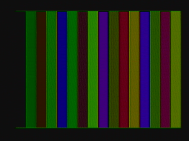

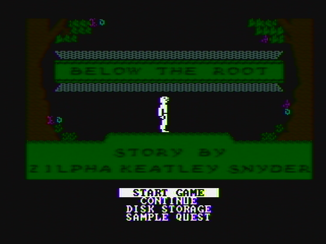

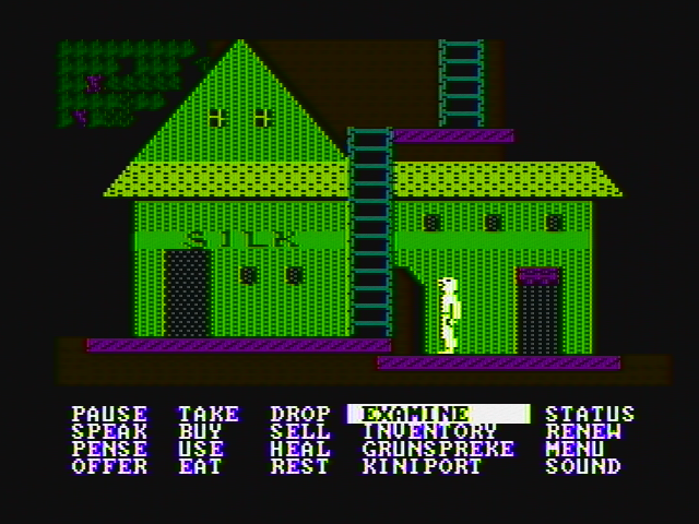

Reply 433 of 753, by Servo
Ok, I made a few captures. Turns out my memory was off, the colors are more different than I remembered. Based on the composite display, the high intensity white and low intensity other colors is actually correct; many of the colors are very dark! It made my captures from the game quite dark/blurry at times. (EDIT: ok maybe not, comparing to the test maybe those are all high intensity...) I also put together a basic program to show all 16 colors; I also did a capture with this on both my PCjr and PC/CGA (along with the RGB version captured in DOSBox 0.74). Captures attached, I'll be interested if you can figure out what's going on!
    194.26 KiB
    2144 views
    299.74 KiB
    2144 views
    384.44 KiB
    2144 views
    378.94 KiB
    2144 views
    1.16 KiB
    2144 views

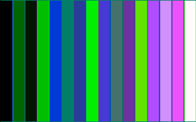

Reply 434 of 753, by VileR
Reiver102 wrote:
You're right; my mistake, I was using ykhwong's 0.74 build instead of the regular 0.74; it works fine in the regular version. But anyway, wasn't posting that with the intent of resolving that particular issue, merely trying to assist with the current project at hand, however I can. I really dig what you all are doing here 😁
Eh, that happens - with so many builds around I initially forgot to test with plain ol' 0.74 too.
Also, welcome. Nice to see someone relatively new who's actually interested in emulating anything pre-Voodoo 😉
Very interesting, this... looks like the pure chroma colors (columns 0, 5, 10, 15 in your "scrtest" shot) are practically the same as new CGA, and looking at them alone, they do match the premise of hi-intensity white and low-intensity cyan/magenta. But as soon as they're blended (all other columns), a different amount of hue shifting seems to kick in in each case.
To test, I tried to force this palette (0, 3, 5, 0xF) in the composite calculation code, and you can see the results [EDIT- removed, see new post below]
It's sort of interesting that this mode artifacts in green and purple: rather Apple II-like. From an aesthetic point of view, I'm liking the PCjr look of Below the Root - very forest-like, for lack of a better term. 🤣
