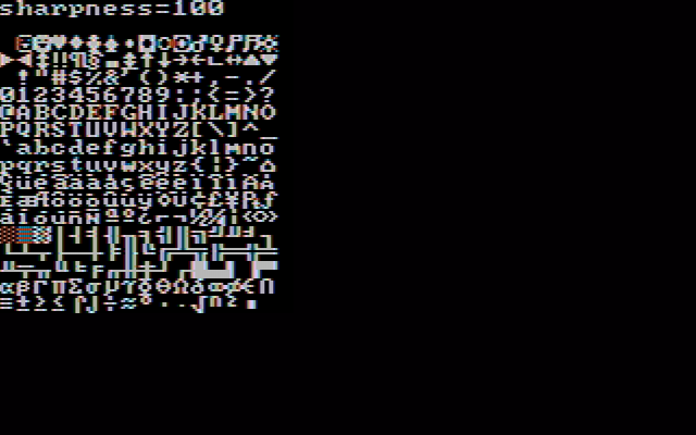

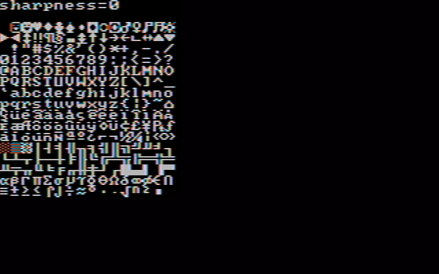

Played around with the latest patch and noticed a couple of things:
- mode 5 is shown in color, unlike current SVN (given the new method, I assume that a fix wouldn't be trivial?)
- in new CGA mode, the default brightness/contrast values may be a little off (high white is 239,239,239)
Other than that, looks great to me. Sharpness=100 does make the text somewhat nicer, although it looks good enough at 0, too:

By the way, should sharpness be limited to around 0-200 or so? (right now it's possible to set negative/arbitrarily high values.)

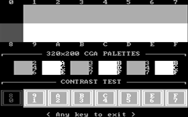

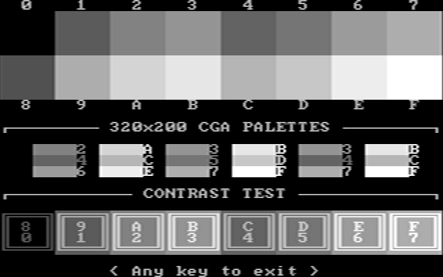

reenigne wrote:
Whoops - actually it's quite trivial (I just completely forgot about it since it doesn't work terribly well on real hardware). I've fixed it in the attached patch (though not tested it yet).
Hmm, this appears to work as expected for old CGA, but not for new CGA... the latter should represent the 16 RGBI colors as 16 greyscale levels in BW mode, but it looks the same as old CGA:
Whoops again - I took out too much. This one should be right.
Reply 632 of 753, by VileR
Yep, BW mode looks correct for new CGA now - nice!

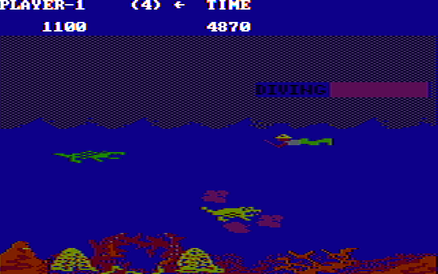

Reply 638 of 753, by VileR
Yet another advantage of this new patch (vs. SVN) is that line-wise palette changes are now supported:
10.98 KiB
238 views
(new-style CGA - compare to this.)
By the way, this shot was achieved by kicking up contrast and saturation considerably, and lowering the brightness. This seems to give results much closer to the output of real-life new-style CGA cards -- they all share this darker, more saturated look compared to the default settings. Therefore, it may be a good idea to *offset* the default values (for new CGA only) with these adjustments.
