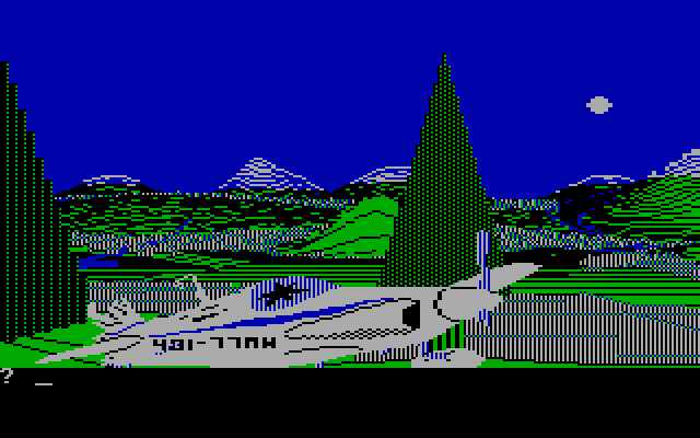

EDIT: This is what I've got in Wilderness: A survival Adventure.
The composite photo is with the hue adjusted and sharpness as well.

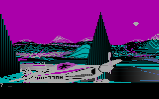

Reply 748 of 758, by MKSheppard
You know, I loaded up regular Wilderness in Standard 4 color CGA mode, and then altered the screenshot in Paint Shop Pro to alter the hue by -60 and I got this:
And it fits too well; it makes me wonder if the CGA palettes in-game were chosen deliberately (remember, this was 1985/1986) so that end-users would adjust the hue on their monitors manually to get this effect.
It's been so long (and I was only 6 or 7 during that era of computing), but I do vaguely remember older monitors having hue adjustment (possibly a side effect of many of them being similar to CRT TVs?)

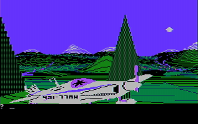

Reply 749 of 758, by VileR
That may be overestimating the effort that went into the artistic decision-making, if there was any... that game was originally an Apple II job, at least according to MobyGames. It was pretty common for folks to just use automated converters when porting graphics to another machine; or in this case just port the vector drawing routines, plug in some numbers for source->target color translation, and call it a day.
The Apple version only uses 4 colors as well, and also has a purple sky. So funnily enough the vanilla RGB CGA version is more faithful to the original.
