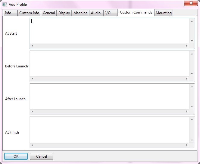

Hi all,
I'm back from vacation to the US! While there, I managed to do some coding for DBGL as well, but unfortunately lost all my changes due to a fatal hdd crash (click-of-death, aaargh 😳). Some changes I've now re-done in this new test-build. They are:
* Support for custom autoexec commands (see attached screenshot) so you can add arbitrary (DOS) commands at various stages during executing of DOSBox' autoexec section.
* Startup optimization by delaying determination of the canonical dir for captures when rendering the image-column, and somewhat improved caching of the images. (mgtroyas)
* added 'all regions' checkbox in settings dialog for MobyGames cover-art images. (gbbbs)
* implemented column image stretching, with or without respecting the original aspect ratio. The options are available in the settings dialog. (mgtroyas)
All the latest files.
To upgrade, grab the dbgl.jar as usual.
