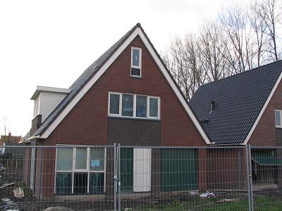

    My house is the one on the right

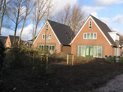

    The front

Nice. Congratulations. You will be done indoor just in time to get the garden ready 😀
