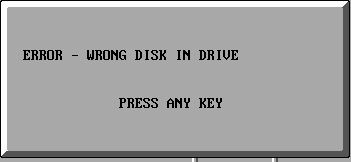

I have an application that runs in DOSBox on a Mac (OS 10.3.9). The program have to run from the CD. During the initialization, it does recognize that it is running from a CD Rom.
I have a C:\ drive set up for its temp subdirectory - and *.tmp files are written to the temp folder.
The software works up to the point where it has to go back to the CD to get additional information, and I get the error message
ERROR - WRONG DISK IN DRIVE
Is myy conclusion is that the software does not recognize itself as a VOLUME correct?
Attached are two files - one from a PC (software works) and from DOSBox (wrong disk...).
So - is there another way to mount a CD ROM?
I used mount e /volumes/TestCD -t cdrom -ioctl
to mount the CD Rom.

Reply 9 of 11, by ArturoYee
Well, it was a bit of a problem in getting a good ISO. Apple disk utility created an image that could not be mounted - Burn 1.71u crashed when it worked on the .exe.
But I did get a good ISO from my XP machine (using CDBurnerXP Pro 3.0). Thats the good news.
Bad news - same problem.
This is using:
imgmount e /TestCD.iso -t iso
Attached is the message I get:
    7.04 KiB
    665 views
Reply 11 of 11, by ArturoYee
There is more then one file on the cdrom.
I did a dir *.cfg to get the one file, and try to show that the volume label is not presented. There are 62 files on the CD - 464 megabytes of data.
Yes, it is the right disk, the exe did run, and it reads all the supporting files it needs to run. It is after it gets instructions from the user to extract additional information that it "discovers" that it is the wrong drive.
The error message is from the application.
