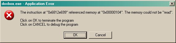

I tried installing DOSbox 0.70 on my laptop and my workstation. I got the Windows "Application Error" stating:
The instruction at "0x6812e699" referenced memory at "0x00000104". The memory could not be "read".
What gives?

Reply 1 of 11, by DosFreak
What operating system?
What video card?
What DX version?
What video card driver version are you using?

Workstation is Windows 2003, laptop is Windows XP.
DirectX 9.0c of Feb 2007 is installed.
I use the standard drivers given by Windows.
I'm not sure if the error address and reference is exactly the same. I'll check 'em first.

Gee, I thought I have posted my reply... 😦 ... apparently my ISP had eaten my reply. So, here's an update:
For the Windows 2003, I have installed 865 driver from Intel. Now DOSbox runs without error.
No such luck (drivers) with the laptop...

I have the same problem, the weird thing is that DOSBox 0.65 works fine. The problem only occurs with DOSBox 0.70. but I tried the 0.70 version in my other Windows instance (clean installation) and it works good. I don't know what is the problem. :<
Reply 11 of 11, by butterfly
That's been suggested already but when I tried DOSBox on Windows 2003 I experienced the same problem. It was enough turning hardware acceleration to the max.
