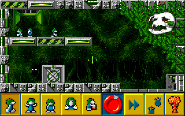

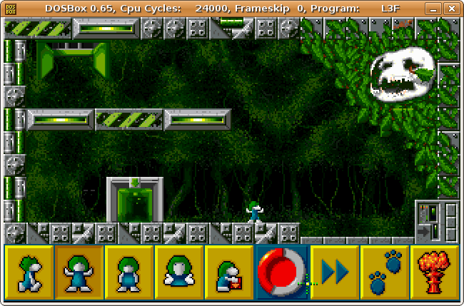

I play Lemmings 3 (Chronicles / All new world of) with DOSBox and noticed the levels are missing a line of pixels just above the buttonbar.
I attached to screenshots, one showing the first classic level the way it should be and the other showing the way I see it.
Can someone confirm for me that this error is in DOSBox?
    22.74 KiB

    This is the way the level's suposed to show.
    59.9 KiB
    1374 views
    Look closely and you'll notice the missing line above the buttons. The gray squares miss there ridged edge.
Reply 1 of 11, by ErikGG
It could be because you might have set a scaler. Set it to 'none' if it is set to 'scale2x'.
And set Aspect ratio to 'true'.
Also set the Windowresolution and Fullresolution to 'original'.
Don't know anything else that might fix this for the moment.

Where is that screenshot you attributed with "good" from?
As it has 201 pixels vertically, whereas the game sets the 320x200
mode and doesn't change it.
It looks a bit odd that a pixel row would be missing somewhere in the
middle of screen and not at the top/bottom (where the screenshots
are the same).
Reply 3 of 11, by evaarties
@ErikGG
I tried the game with those settingsadjustments you mentioned, the line keeps missing.

I don't know where I got that screenshot from anymore but I searched again and found this url: http://it.travisbsd.org/lemmings/lemmings3.php notice the screenshot ( http://it.travisbsd.org/lemmings/img/screensh … s/lemmings3.png ), it's 640x402 so it's probably made with DOSBox. The pixelline is in the screenshot.

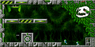

For my site http://home.wanadoo.nl/lemmings-solution I already played Lemmings 3 using DOSBox a few years ago under Windows XP. I don't remember which version of DOSBox I used, but the missing line was shown that time, see the attachment.
NB The screenshot is missing the buttons since I don't use them on my site.
PS Tomorrow I wil run Lemmings 3 again under Windows XP using DOSBox 0.70. If the line is missing, I will try the game with older versions to find out which one did show the line. If 0.70 is showing the line, maybe the linux version is a bit broken.
    20.38 KiB
    1283 views
    Screenshot made with windows version of DOSBox.

Reply 10 of 11, by evaarties
No problem 😀.
Ok finished testing, here are my findings:
0.70 missing pixel line
0.65 missing pixel line
0.63 missing pixel line
0.62 missing pixel line
0.61 missing pixel line
0.60 screen is corrupted
0.58 doesn't run
Well, I can only conclude that there must be more versions of Lemmings 3 for DOS out there since I know for sure I didn't make my screenshot with UAE (I also use the time button, the red circle, and that one is scrambled with UAE).
NB Maybe some of you noticed the screenshots in my first post also differ with the time button, the wrong screenshot shows the time button as it's sticking out, the good screenshot shows it like it's pressed (which you cannot do yourself). Perhaps that's the difference in version I need to look for.
