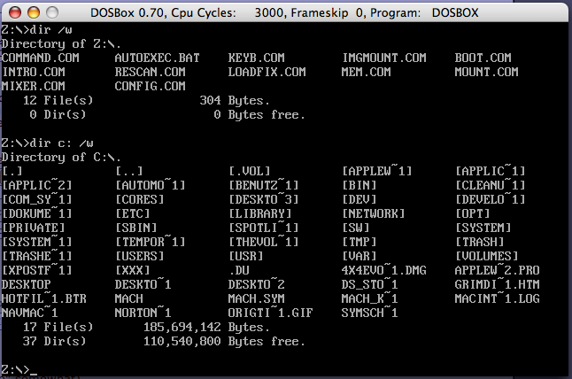

Reply 9 of 9, by IIGS_User
D-man wrote:
Dir of D:\:
[.] [..] [DESKTO~3] [SYSTEM~1] [WARCRA~1] [WARCRA~2] [WARCRA~3] [WARCRA~5] APPLES~1 DESKTO~1 WARCRA~4.1RE WARCRA~6 WARCRA~7
7 File(s) 70,155,952 bytes 8 Dir(s)
I'm sure he mounted the root dir of a hard disk (see pict).
The "WARCA~1...7" folders, what does that mean in original? Install disks?
There is some trick to mount images (of these Install disks) into *one* DOSBox letter and change them by pressing key combination.
I'm not an expert in changing mounted images...
    26.75 KiB
    544 views
    See the root dir of a Macintosh HD in DOSBOX: mount c "/Volumes/Macintosh HD/"
Klimawandel.
