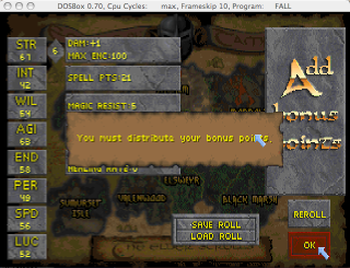

Hi I am new to this DOSBox thing and I am trying to get the Daggerfall demo to work with DOSBox. I am able to run the install through DOSBox and the setup but when I execute the demo, I just get a black screen. What do I need to do to get the game running?
I am running OS X 10.4.10 on a 2x 3Ghz Quad Core Xeon Power Mac with 4 GB ram. THe DOSBox settings are the standard one that came with the mac. I tried some of the PC settings but they didn't work. Anybody get the game working on a Mac? What settings did you use?
Thanks for the help.

Reply 3 of 18, by IIGS_User
1) Open Terminal, drag in the DOSBox unix exe (located in DOSBox.app/Contents/MacOS/ by right-click "show packet content").
2) Create a folder daghd (to be used as Drive c: ) anywhere at your hard disk, drag it into terminal (to see the command line as shown in daghd.png.
/Volumes/pathtodosbox/DOSBox.app/contents/MacOS/dosbox /Users/yourname/pathtodosbox/daghd/
This is the first part in the long line of Terminal command.
3) add " -c mount d "/volumes" to the line (w/o enclosed quotes, just the quote left from /volumes).
mount d "/volumes
4) drag in the unstuffed demo folder, enclose it with a quote.
-c mount d "/Users/yourname/pathto/Dag/". The command line should read like this:
/Volumes/pathtodosbox/DOSBox.app/Contents/MacOS/Dosbox /Users/yourname/pathto/daghd/ -c mount d "/volumes/Users/yourname/pathto/Dag/"
5) do not press enter, but add " -t cdrom -label \"dag\"" after the line.
/Volumes/pathtodosbox/DOSBox.app/Contents/MacOS/Dosbox "/Users/yourname/pathto/daghd/" -c "mount d /Users/yourname/pathto/Dag/ -t cdrom -label \"dag\"" -c frameskip=10
I added -c frameskip=10 here, otherwise you'll have to look the intro screen for a long time. If frameskip=10, you can install alomst immediately.
All this will mount the daghd as drive c and the downloaded and unstuffed zip file will be mounted as CD ROM drive (as drive d: in this example)
Be sure, your path to the emulated CD ROM doesn't include space bar (' ').
6) Press return to start the DOSbox
7) Type in "d:", then "install".
Since all files are stored at your hd, you can choose minimum install.
For me, it starts now.
Once installed this way, you can add the demo to your frontend.
In this case, choose /daghd/dagdemo/dagdemo.exe as drive c: and you need still the /dag folder as CD ROM drive to run the demo.
This is the point I must give up, because I don't managed to run this demo by a frontend, mostly the one i created. But for now, I found an error in it which doesn't mount any other drives than C:, when running a game from the games list. Fixed the problem in the source code, but the demo still asks for its cd (the folder "/dag"), if started from insde the frontend even the "CD" has been mounted.

Reply 4 of 18, by loki23
Thanks IIGS_User, I got it working up to a degree. After pressing return in the terminal, DOSBox starts up fine but when I try to change from C: to D: it says that the D: drive doesn't exist. Should I have the terminal point to the daghd folder or the Arena2 folder (where the cd contents are)? Or should it point somewhere else? You refer to "path to DAG", and I can't find any files named "Dag". Did you just abbreviate it? Same for the cd label?
edit: here is what I am inputing into terminal:
/Applications/DOSBox/DOSBox.app/Contents/MacOS/DOSBox "/Users/xxxx/Games/Daggerfall/daghd/" -c "mount d /Users/xxxx/Games/Daggerfall/DAGDEMO/ -t cd rom -label\"dag\"" -c frameskip=10
xx=my user name
edit2: DOSBox reports it as an "illegal type cd"

Reply 6 of 18, by loki23
thanks MiniMax, I didn't see that. Ok now it is recognizing the D: drive but it won't let me install the program because it is saying that it is missing a file: data\dagger.col
The file DAGGER.COL is in the folder "data". what should I do now? Is dos case sensative?
