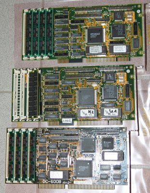

This lot was not cheap...who else was bidding an that? :-p
But now I have 3 Tekram ISA IDE-Cache controllers in like-new condition. I know that they are quite useless with CF-cards but they are cool 😉
1.77 MiB
1620 views
And 2 486 boards:
1.64 MiB
1620 views
1.35 MiB
1620 views
Will sell the remaining parts (industrial cards) to get my money back 😀

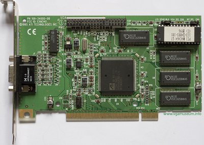

ATi 3D Rage 2MB - aka first 3D gaming card from ATI.
    310.34 KiB
    1385 views
    ATI 3D Rage

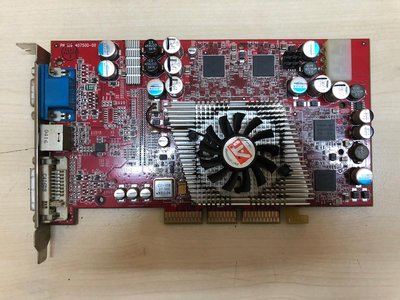

Got me this for a small sum. I know someone who wants to trade their 6x86 PR233 against this card. You reckon it's worth the trade? I already have a 9800 Non-Pro and an X1950PRO AGP.
    307.22 KiB
    1203 views

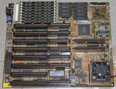

The mailman always knocks twice, so I got more goodies in:

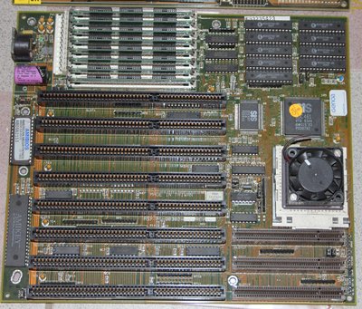

There are issues with this board; legs 100-105 of the northbridge were badly bent and shorted, so I straightened them. Leg 105 is also seperated from the PCB so that will require some solder touchup, no big deal.
The major problem I have, though, is that the resistor network that is supposed to be plugged in to RN6/7/8 to determine cache amount is gone, missing. Does anyone know what the rating of that RNA should be? I've checked and most of the RNAs on the board are either A 103 G or B 100 G..
I've found this image on the net:
355.73 KiB
1160 views
From what I can gather it's a B 8000 J? Can anyone confirm this is not a crazy value for this component?
Reply 25533 of 53103, by stamasd
appiah4 wrote:
The mailman always knocks twice, so I got more goodies in: […]
Looks like 8B000J
Don't use just me for reference, but for resistor networks the marking can be interpreted as follows:
8=number of resistors
B=some manufacturer-specific code
000= value of each resistor (00 followed by 0 zeros ohms)
J=tolerance, J usually means 5% (what is 5% of zero? 😀)
i.e. the resistor network may be just a shunt. But check what other people think too. Don't lose the magic smoke just because I said that.

Reply 25534 of 53103, by keropi
Yes I also believe the resistor network is just a shunt, just a fancier jumper

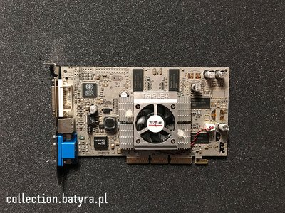

But if you like it - here goes some new stuff postman brought me today... (I know that two more packages are waiting for me in customs)

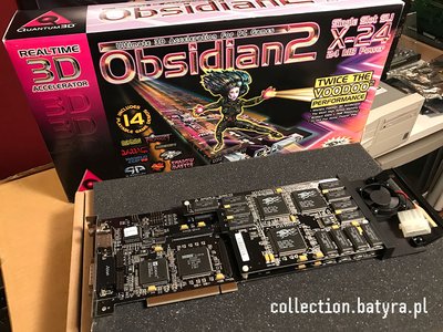

Quantum 3D Obsidian 2 X24 200SB with box in great shape and rare original cooler
263.75 KiB

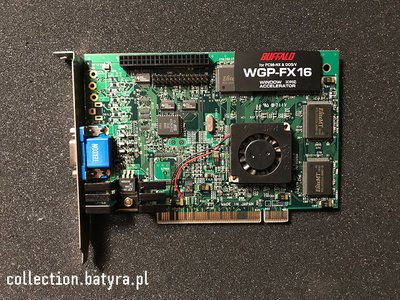

Banshee PCI Buffaloo
346.25 KiB
1046 views

Triplex Xabre Plus 64MB - Xabre 200
333.91 KiB
1046 views

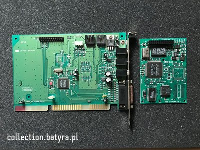

IBM S-W1C 1MB
326.93 KiB
1046 views
IBM S-W1C 1MB
Reply 25536 of 53103, by bjwil1991
The first one: *drools*
Reply 25537 of 53103, by appiah4
Does it connect all eight holes in parallel? Where can I get this part, aliexpress returned nothing. Is it juryriggable?
Reply 25538 of 53103, by stamasd
appiah4 wrote:
Yes, a piece of wire that connects all 8 holes. If I were to make it, I'd get some standard pin contacts like these:
..and solder a wire across 8 of them, then plug the other end in.
I/O, I/O,
It's off to disk I go,
With a bit and a byte
And a read and a write,
I/O, I/O
Reply 25539 of 53103, by canthearu
Normally the resistor network would be something like 10KOhms. I wouldn't necessarily use a bridged jumper array to replace it, as that may either waste a lot of power or burn something out, or prevent other components from being able to reliably pull down the logical lines these are pulling up.
