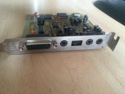

Also an Aztech...SoundGalaxy BX II for 14€ shipped 😀 Think 8-bit soundcards are a good investment in general 😉

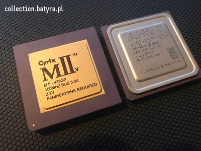

Got theese two monsters today… Both seems to be quite rare.
The fastest Cyrix MII (the last "original" cyrix) 433GP
The fastest of "them all" (fastest CPU ever made for SS7 platform) AMD K6-III+ 550
    159.83 KiB
    926 views
Reply 26063 of 40033, by cyclone3d
OOOHHHH! Very nice! I've got a couple of the bog standard K6-III+ 450 CPUs. I've never even seen a 550 for sale but I also don't go looking that often either.
However, with an ASUS P5A or P5A-B motherboard (pre-bug version), you should be able to very easily overclock to 660Mhz or 720Mhz as the 120fsb actually works on those boards.

Reply 26064 of 40033, by The Serpent Rider
Never.
Reply 26066 of 40033, by dionb
Never.
"Never" is a big word. I was able to reach 633MHz with my K6-3+, which was nowhere near a record breaker. I'd agree that 720MHz is unlikely, but 660MHz is worth a shot.
Reply 26067 of 40033, by The Serpent Rider
600? Sure, easy. Everything higher is not easy at all due to various limitations (including some nasty CPU FSB wall) and might even require considerable voltage increase. Therefore my statements remains the same - never.
Very nice. Although by MHz this is one faster:
http://www.cpu-world.com/CPUs/K6-2/AMD-Mobile … -2+-570ACZ.html
Not sure what is the difference in the real world apps or benchmarks - probably K6-3+ still wins by a 1-2% 😉
