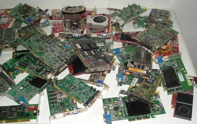

This lot (sellers picture):
561.1 KiB
1339 views
452.59 KiB
1339 views
I see
- C&T EGA - reason I bought it
- SB 16
- SB AWE 64
- Voodoo 1
Remaining parts seem to be unintersting and will be sold again to get some money back 😀

Predator99 wrote:
This lot (sellers picture): […]
I see
- SB 16
- SB AWE 64
- Voodoo 1
The card in the upper right hand corner looks like a PCI Voodoo Banshee, like this one:
http://www.amibay.com/showthread.php?42764-Vo … I-Graphics-Card
Looks like a fun lot to dig through. Definitely look up anything you aren't sure about. I've found some gems lately that I'd almost put in the scrap pile until I realized what they were. For example, a Tseng ET1000 EGA card that looked like a serial\parallel card or a basic looking AGP card that turned out to be an original (pre-Ti) Geforce 3.

Ozzuneoj wrote:
The card in the upper right hand corner looks like a PCI Voodoo Banshee, like this one: http://www.amibay.com/showthread.php?427 […]
I see
- SB 16
- SB AWE 64
- Voodoo 1
Hahaha nice one! I wanted to say the same thing. Banshee's can be rocognised fairly easy (only some i740 cards can look a bit like them). I just love spotting cards from pictures, it's a sport 🤣
I see
- SB 16
- SB AWE 64
- Voodoo 1
Good eyes..! Wouldnt have recognized this one, maybe after reading the text "Maxi Gamer Phoenix". Thanks for notification!!!
Reply 26486 of 53138, by dionb
There's more interesting stuff in there.
- Something with a lot of SGRAM in the upper left hand, covered by the rear of the SB16. Not totally sure, but it looks like a Matrox Mystique 220.
- Triangular OEM (HP or PB) Aztech 2320-based ISA sound card, SBPro2.0 hardware compatible with real OPL3, almost no noise and none of the Creative bugs.
Not so confident about the newer AGP cards, but good chance of a GF3 in there too I'd say.
Reply 26487 of 53138, by appiah4
The AGP card on the far right lower corner is a Ti200 I think.
The card on the upper right, the PCI VGA, is certainly a card that I would have liked to have, it seems to be a 96-98 era PCI card and those are always interesting to me..

dionb wrote:
There's more interesting stuff in there. […]
I agree, the one is a Matrox card. Probably a Mystique. As for the Aztech 2320, I thought I remember reading complaints about getting these set up or something... can't remember. And I don't think they have a real OPL3, but people here have said the FM sounds pretty good anyway.
The card at the upper left that looks sort of like a GF3 is probably a later FX or Quadro variant of some sort, since it has BGA memory.
Definitely a Ti 200. I have one just like it.
And the PCI card is a Banshee. Probably a Guillemot Maxi Gamer Phoenix. I always found the "Phoenix" name to be kind of ironic, given how unbearably hot Banshee cards get with their undersized heatsinks. I've seen some of those Ensoniq branded Banshee cards that had turned brown (even the heatsink was golden brown) due to heat damage over time.
The 2320 is an ISA PnP card, with all the headache ISA PnP gives you - but that's no different to the SB Vibra under the pile in the middle. I'd only recommend it with a board with good PnP implementation. The AZT2320 contains a legitimate licensed OPL3 implementation (it should even show a tiny OPL logo on the chip).
What can differ is the filters, most Aztechs are pretty 'raw' which you may or may not like.
Isn't that the Banshee?
In any event, I see an S3 Trio or Virge PCI card on the bottom under the AWE64 and Zotac, and something else with a lot of DRAM chips below that - probably also a similar S3 card. This is a nice pile for various things 😉
I see
- SB 16
- SB AWE 64
- Voodoo 1
Oh, and the big card with the black and gold heatsinks at the top of the pic is an Asus HD3850... sadly it is probably PCI-E, not AGP. 😉

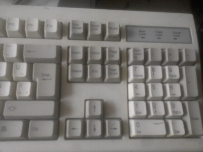

Is this an AT keyboard worth buying? Seems to be a well built modelwith key prints on the sides of the caps and whatnot, possibly mechanical?..

ALL AT KEYBOARDS ARE WORTH SOMETHING.
Hell, i'd buy a keyboard from a thrift store with actual feces on it if it was cheap.
Reply 26496 of 53138, by dionb
All keyboards...?
There are definitely things out there I would buy in almost any state of filth (Model F or Model M...), but equally really low-end rubber dome monstrosities I would not touch NIB for free - which actually includes chicklet-style keyboards we're getting at work these days.
Don't immediately recognize this one - it could be a nice mechanical board, but those Windows keys make it look suspiciously new for that. If not it might still have usable keycaps. Or it could be a nasty spongey membrane thing. No pics with model #?
Reply 26497 of 53138, by appiah4
dionb wrote:
All keyboards...?
None unfortunately, but it looks like something from an OEM PC or at least one of the better builds rather than a generic cheapo AT membrane keyboard..
