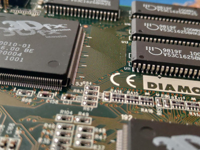

Well, my second Diamond Monster 3D 2 (8mb) card came in today, and iv found out my 440bx board just refuses to POST when the new V2 is anywhere near it 🙁
So now i gotta go through the long process of figuring out weather the card itself bit the dust or its something on my end, and if it is dead, then coxing a refund out of the seller.

Do a visual inspection of the whole card. The legs of the big chips bend easily and can cause a short.
Was it sold as working?

Cyrix200+ wrote on 2020-03-10, 09:49:
Yup, found 2 bent legs touching on two of the big 3DFX chips, think that's the culprit?
OKAY...so now I'm mildly freaking out as I really don't know how to separate these safely. I tried using a sowing needle to push in-between them but stopped half way through because I was freaked out over damaging the card 😵
Anyone got any advice on how to deal with these bends?

You can use a small, flat tipped (bladed) screwdriver and press the legs to the left (rear of the chip) and to the left (front of the chip) in question. Please be careful with this and the sewing needle method should work as well.

SodaSuccubus wrote on 2020-03-10, 17:29:
Yup, found 2 bent legs touching on two of the big 3DFX chips, think thats the culpurate? […]
OKAY...so now im mildly freaking out as i really don't know how to seperate these safely. I tried using a sowing needle to push inbetween them but stopped half way through because i was freaked out over damaging the card 😵
I use a modeling knife.
